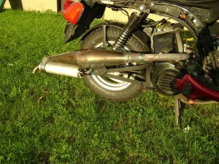

Got my 87 Elite with 125cc Stroker running like a Raped Ape but it's Really loud with the V8 pipe.
Any Recommendations on a Quieter but good flowing Pipe ?
Pic of Current V8 pipe..

graphite9 wrote:thats not a v8, and it looks like thats not a 120cc pipe..I had the big scorpion, and it was a screamer. I don't think there is any way around the noise.
Well it came with the Engine when I bought it, Says V8 on it, was blue before I powder coated it black.
How do I tell if it's a 120cc Pipe ?
I don't think the Neighbors like it when I ride by with it screaming at 9500rpm..lol

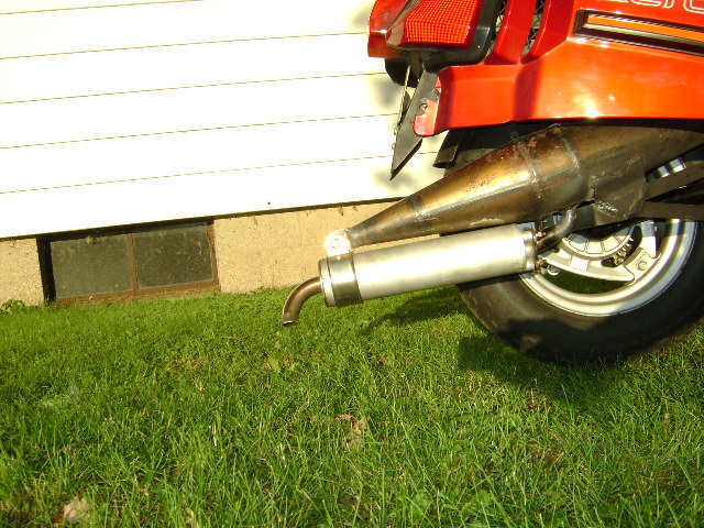

Cut the u-pipe off the convergence cone of the expansion chamber and weld that hole shut, using a small hole saw on the belly open a spot for your tail pipe and weld it into the belly. The performance will not change but the noise will greatly be reduced.
You can Google the subject of belly exit expansion chambers to get more technical information.
My pipe used to look like yours, ear splitting noise, changed to belly exit and noise greatly reduced with no performance change.
You can see the photo, to get the idea.
Dio pipe 010.JPG (142.74 KiB) Viewed 17878 times

Johnniespeed wrote:Cut the u-pipe off the convergence cone of the expansion chamber and weld that hole shut, using a small hole saw on the belly open a spot for your tail pipe and weld it into the belly. The performance will not change but the noise will greatly be reduced.
Thanks for the info "Johnniespeed". After a little Research I figured what the Heck and Give it a Shot and Make my Pipe into a side Bleed Pipe.. Guess what . It worked Better then I hoped it Would. After a couple rides around the Block I Noticed NO changed in the Bikes Performance. But I would say it DID Quiet it down 50-60%... :rock:
Here's a few pic of Exhaus after Mods. I still plan to remove it again so I can Sandblast and Ceramic coat it..

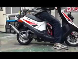

Found another cool example
I think something like that would cure my header smash anxiety

there are a few pipe ls like these on yahoo auctions japan for AF18 and variated AF05E .
