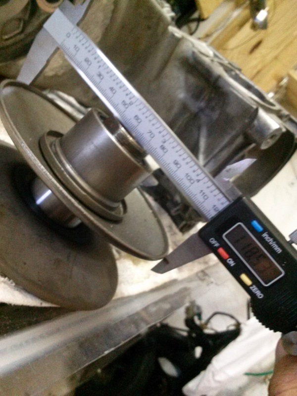

I just noticed that in your original post you are asking about specific belts for your oversized 118mm rear pulley. I'm pretty sure no one else has reported installing that sheave, so direct experience will be hard to find. If the ZX pulley is 108(?) mm, and you're adding 10mm, then 3.1416/2 cm. should be added to the belt sizes in my responses. (Half of the added diameter) for a pretty good educated guess. So a 685mm belt should be about equivalent to a 669 on a 108mm rear pulley.
You definitely want to get all of the 18mm of width, but if you go much longer I predict it'll slap around and fray the outer belt covering, leading to premature delamination and failure.

hi W111,Now you got it,yes the diameter of rear pulley is 118.5mm(pics),well... if nobody try it yet may be I have to spend some money on belts and try out.and the fan too...I'm a :crazy:
