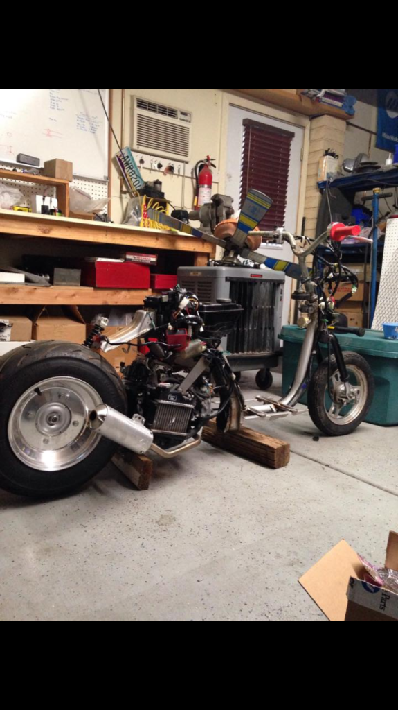

I agree to both posts above but I do like the wheel options for the GET and understand where your trying to go. As long as fast isn't your idea you'll be fine. Found this pic today figured I'd share with you.
