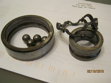

Pulled out the engine and tore it down. Used the kitchen table, which is one of the perks of not having a gf. ;) Main bearing was shot; the cage in the bearing was only holding 2 of the 7 balls in place.

The other balls were running freely between the two races. Crank has play in it. Replaced only the bearing and reused everything else. Crank spun smoothly after the replacement.

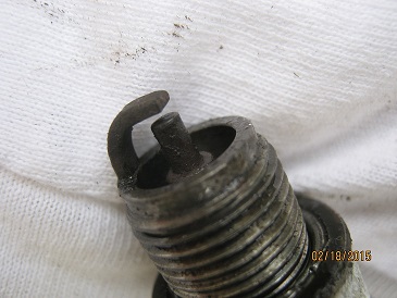

    b. See close up of the spark plug. Looks like it is a little rich?

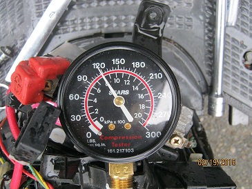

  2. Compression
    a. Put the compression tester on there and cranked with WOT. 115 PSI.
    b. See picture

Oh, and here is what is left of the bearing.

<sigh> I'm an idiot. I know.
I replaced the spark plug on a whim, and it runs fine now. I thought I had excellent spark, but no....
Hopefully someone else will be able to gain something and troubleshoot their scoot based on this thread.
