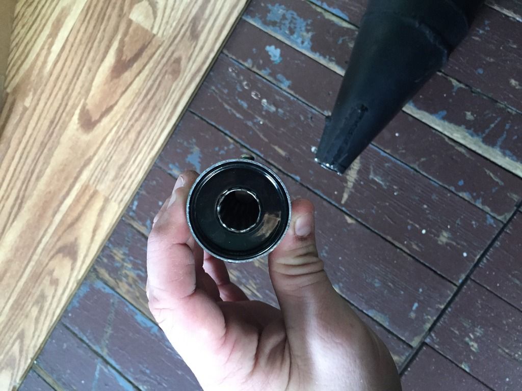

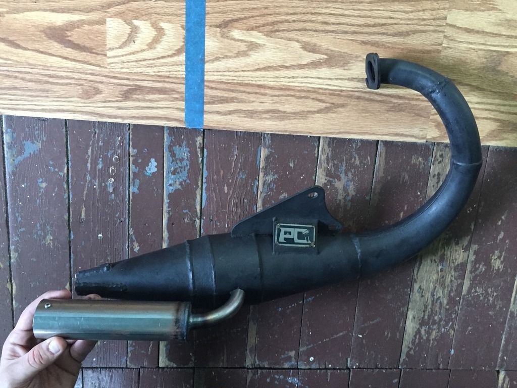

The pipe.
The stinger
And the Side Bleed canister I plan on using is found here. http://www.treatland.tv/MLM-side-bleed- ... le-315.htm

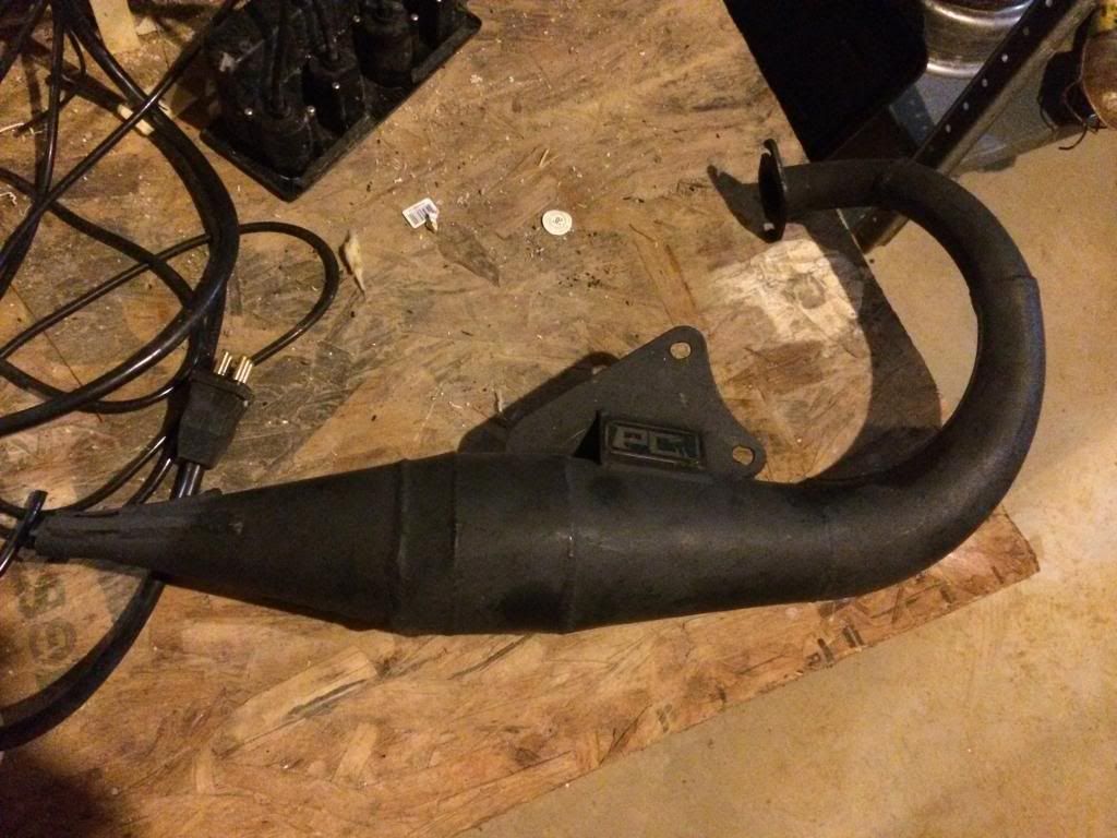

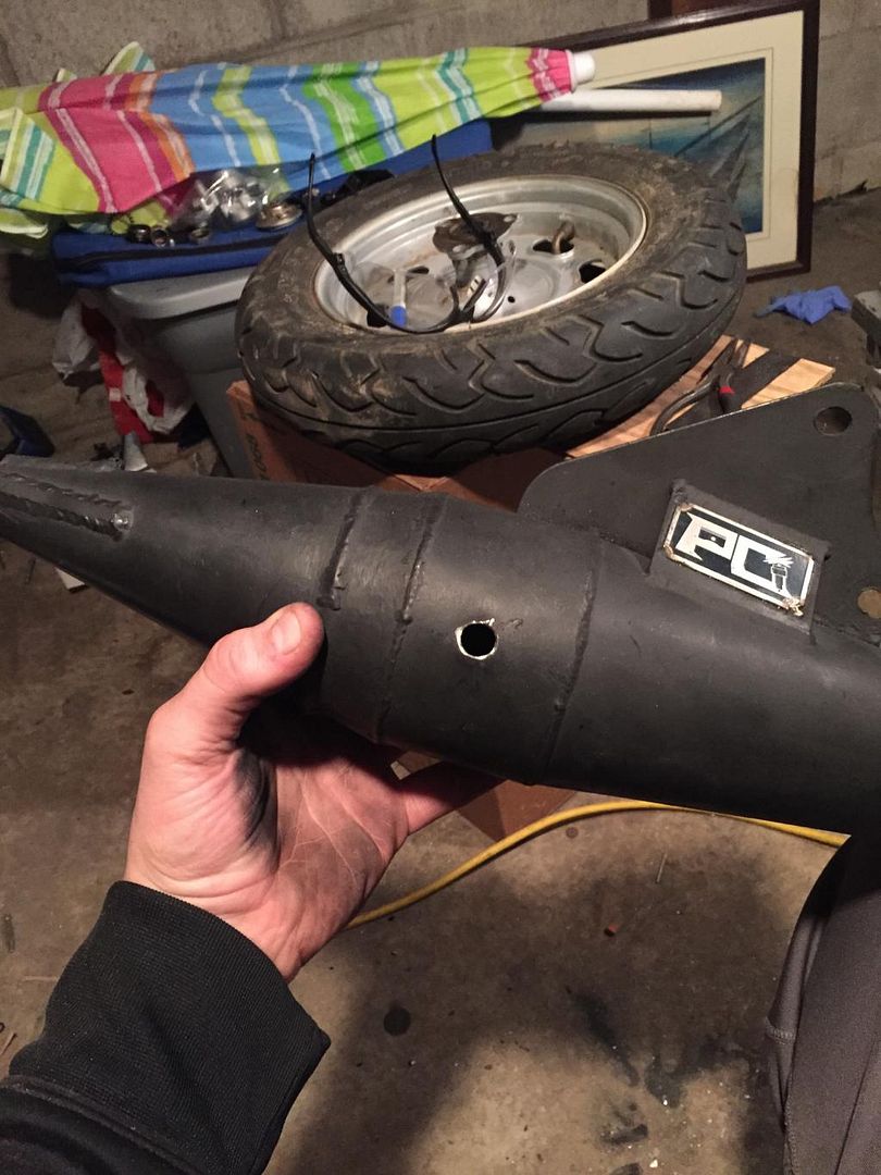

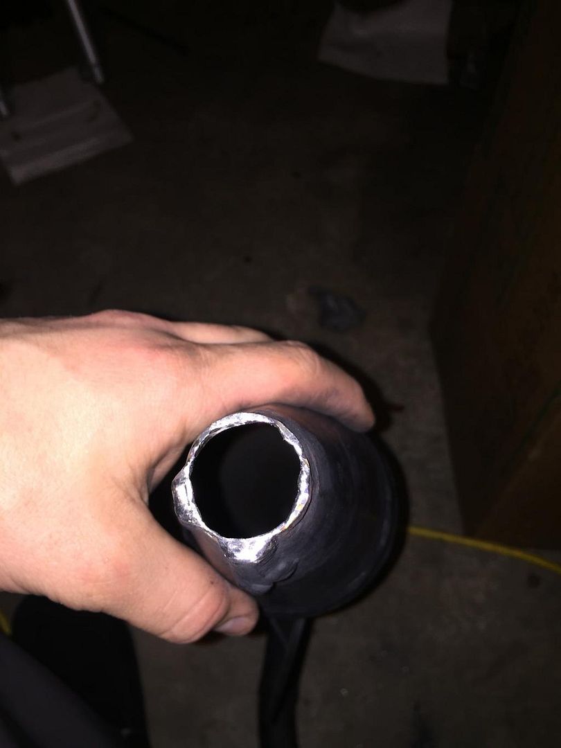

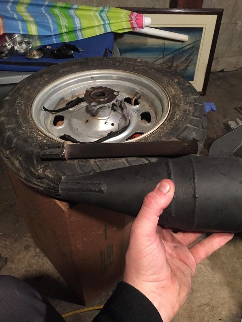

So far I cut out the stinger it was way longer then I would have expected lol. And cut a hole for the side bleed. It's not cut to size yet I'm gonna wait for the canister to get here. So just gotta find a good cap for the end of the cone and weld in the side canister. O yeah and wait for the snow to melt! d*** you Michigan!!
Cleaned up the end inside
And cut my side hole. Image
Looking to make it look just like the spree MLM pipe Image

people call these pg pipes and scorpion pipes not chamber type muffers but all of them are underneath .As you can see from the pics above the rear section on these pipes are the mufflers once removed your left with the chamber section under neath.

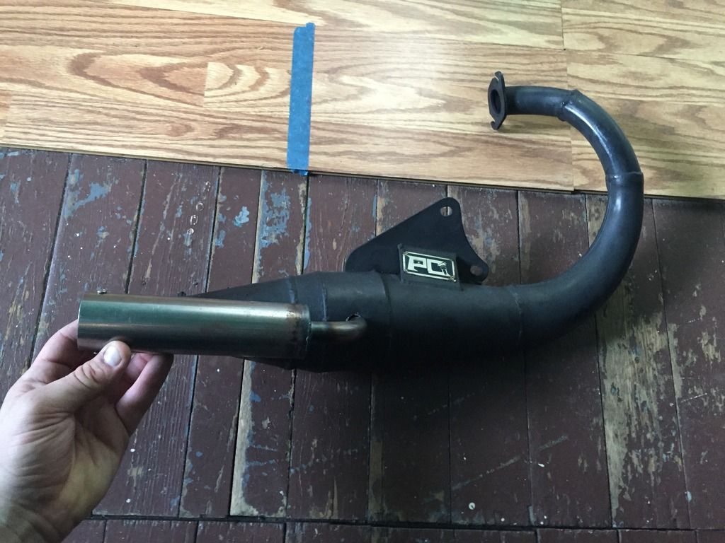

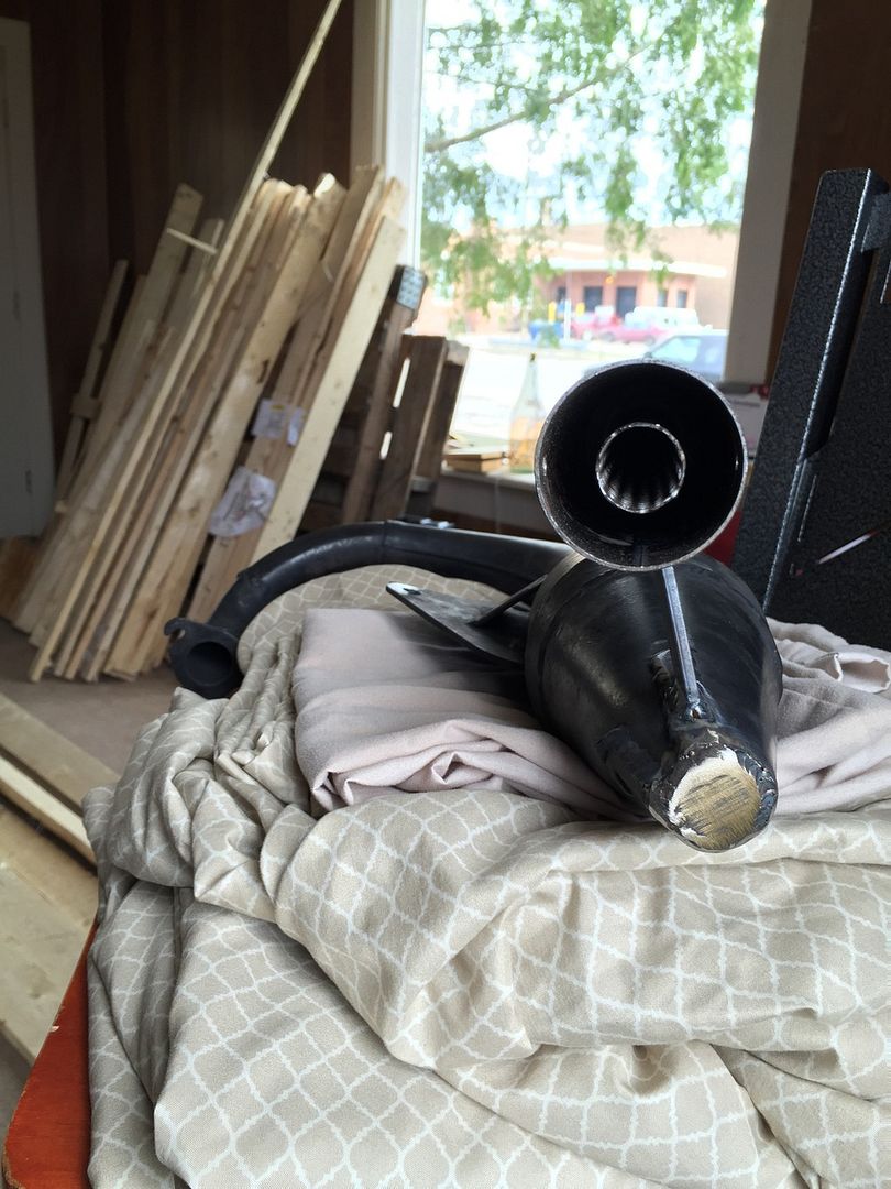

Got my side bleed silencer in from treatland today! It's a little smaller then I expected but I was comparing to the spree MLM pipe which I've never seen in person. I'm going to get the pipe to my welder in the next couple of days and get it out together. Should have this motors chassis assembled this weekend then I have to run the wiring and should be able to test this bad boy out!
What do you guys think? Go all black or should I go chrome? I have both black engine paint and chrome header paint just not sure yet.
Straight on shot.
Top view.
Head shot

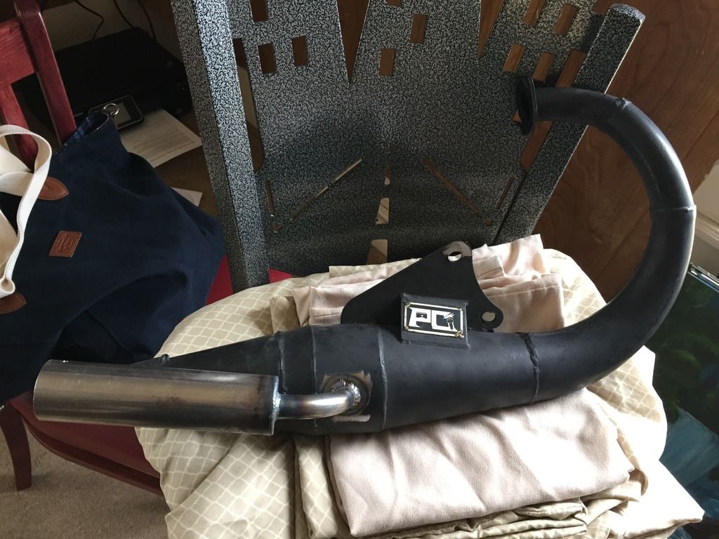

Got the side bleed back from my welder today! Looks great! Prolly get it sanded down and painted up and get the silencer repacked this weekend. Image
1man8scoots
Posts: 1119
Re: Side Bleed Pipe
Post by 1man8scoots »
There should be a tip on there curtis. It will direct the exhaust to a single outlet and help the flow. You can try it both ways but I always noticed a difference on quads and dirt bikes when the silencer was missing the outlet. Also a lot more noise. The perforated area should be wrapped in fiberglass and pipe end installed.

Yeah I have the packing and the end it's just not installed yet because I need to paint it up still. Thanks for looking out though! Here's the end installed Image
