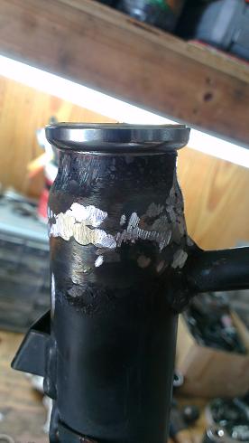

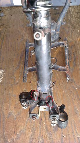

EDIT: Some of this post is missing from the beginning so I will try to replace it as best as I can but you can get any headset to fit on any other scooter frame as long as you are willing to take some risks, make a fearless effort, and do some real involving work with a variety of tools and machinery._____First, I went online to the yahoo japan auction site and purchased a nice condition dio af28 headset and complete front disc brake setup which included the handlebars, speedometer cowl and the wiring and headlight stem, wheels, and all the hydraulic brake system. Then I measured how much the difference was between the two scooters frame, neck and stem and calculated that if I took a 3" section out of the top of the neck on my sa50 Elite scooter and welded the top section back on like it shows in this first pic, it could fit and clear the front cover, and if I cut some of the fender underneath where the stem would have to clear the turning radius, it might work with some finessing and heating up and bending the plastic. Then cut the top for correct size of metro stem and install bearing cup.
IMAG0850 - Copy.jpg (43.87 KiB) Viewed 38260 times

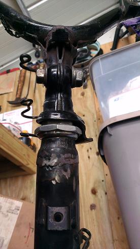

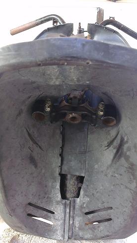

Before moving on, the metro uses a larger bearing on the bottom than the elite, so remove the lower bearing race from the metro stem carefully and replace it with a new (you have to order one from honda) elite lower stem race. It's a press fit so make sure it's all the way on. Right here I want to mention that you can get a stem from a dio with disc brakes and use that instead but it has to be a disc brake sized stem. A drum brake stem is not wide enough to make into disc brake so be sure it's for disc brake! Next, remove some of the material from the stops if you use the metro stem, to suit your steering desires.

With the use of the af28 handlebars, and cutting the neck off of the elite, I foolishly lost the use of the key switch/locking mechanism, but you can cut around and leave the key switch mount bracket.

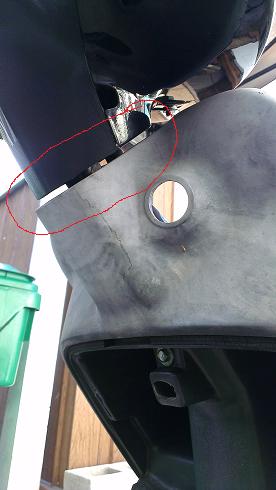

Use heat gun to make clearance for turning radius....then install inner floor /glovebox to check fitment. Mocking-up the parts is crucial for correct look/fit. Install headset for fitment.

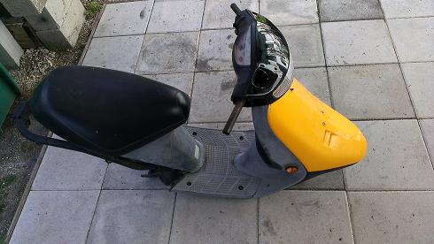

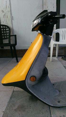

Once everything is to your liking, you must first swap-out the plug-ins for the speedometer to fit the elite. Just cut and splice....easy. Then, prepare to install the dash, throttle cable, disc brake reservoir/lever, rear brake cable......

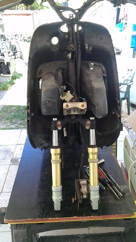

Putting it together..... install the Dio legs.....
IMAG0916 copy.jpg (69 KiB) Viewed 38225 times
finish up headset and dash......install Dio wheels/brakes and front/rear plastics

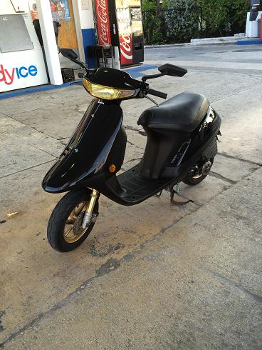

So I have re-painted the faded gray plastics with some nice bumper coating from the local auto parts store, and got some cheap but cool looking mirrors to help it out, then re-covered his seat for him.
Go ahead, shoot us some comments.....I already know it would look better if it was slammed but he don't want that.
