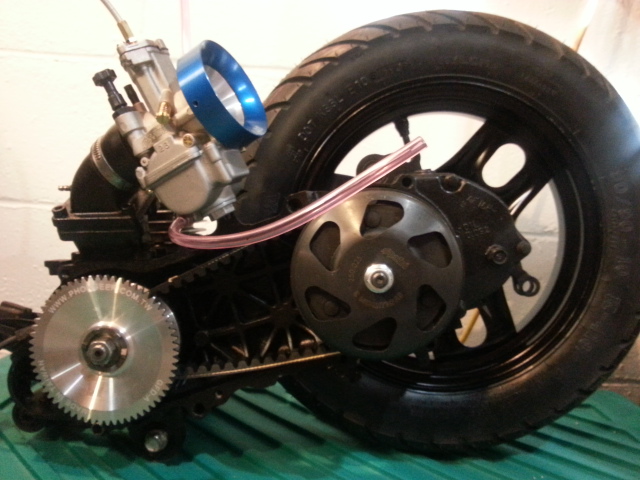

The build for 2k15:
-Yasuni c16
-Ported/flowed cases with Malossi Crank SKF bearings
-Fabrizi 50mm cylinder kit(Ported 189 125 125)
-Polini 26mm carb/Polini anodized bellmouth 130main 45 pilot
-CT manifold with Naraku reedblock(modified for flow)
-Polini for Ruckus variator/Phongeer fixed pulley shimmed
-ZX rear pulley, Malossi ZX Kevlar belt, Polini Evo 3 torque driver, polini blue spring
-Polini G3 clutch Evo bell, blue springs
-Malossi CDI
-9:1
-Metro rims with fresh kenda rubber 90/90-10
-Malossi shoes front and rear with new OEM cabling/Phongeer"racing" levers
-JDM tail
-Str8 mirrors
I paid $100 for this scooter. You will see why when I get to mounting the motor and snapping pics of the bike itself. :roll:

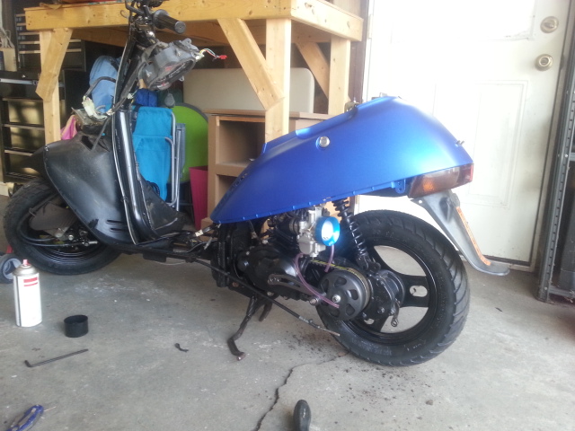

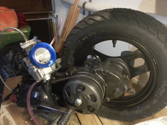

A little more progress today. I need a rear brake cable.

Thank you. I have a lot more work to do with the cosmetics, but im coming close to having it functional.....pending random failure of something stupid like coil or regulator it should be mechanically sound.

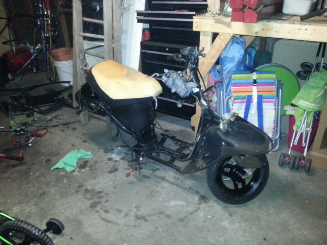

A couple more pics. Ive used a LOT of epoxy and paint this weekend. More epoxy than you'd imagine. Im not very happy with the previous owners. So, I bought this from a guy who gave me the number to another guy that he bought it from to get the registration. Well, that guy had never registered it so it went back to year third previous owner to register it. Thats 3 previous. I dont know how many more theyre were. I can only hope my plastic weld epoxy holds up when the vibrations start.
I could technically fire it up right now, but I have no gas, no oil, the tank may be contaminated, no rear brakes or engine cowling.

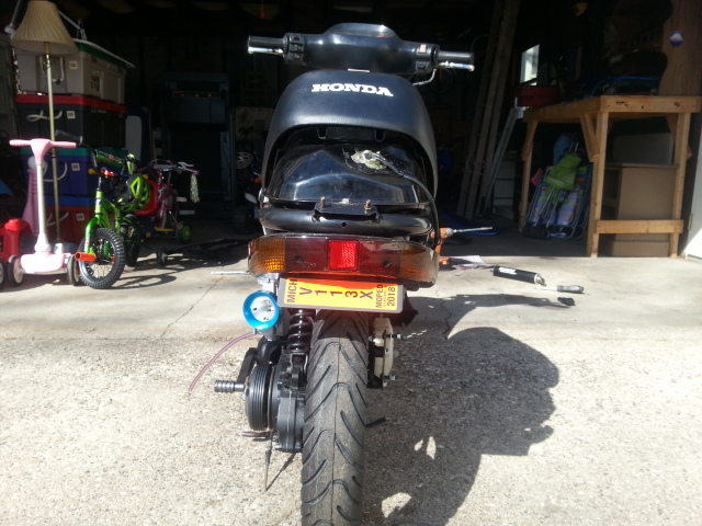

I got the reg paperwork. Had to pay $3 to the government in tax for this thing. $28 total registered til 2018.
