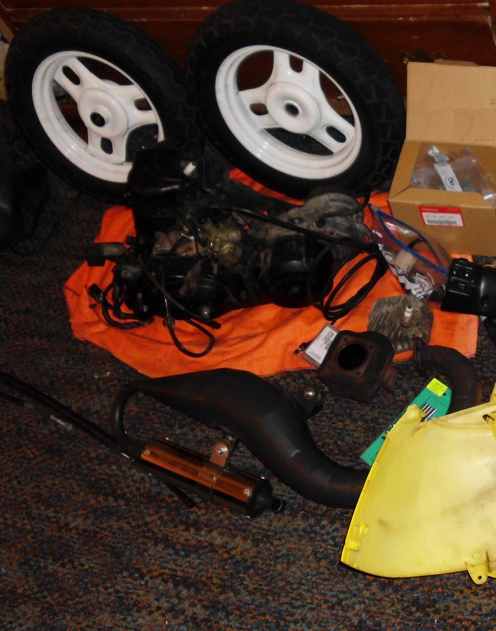

I have a P.O.P. ( pile of parts )
The basis of this build:
To build a running scooter out of this
and parts laying around.
72cc, used Polini bore with new piston and rings,
8.5 gears, 28mm carb, ct intake, arrow rep exhaust,
and cans paint.
2001 elite dosent run. Bad wiring. :(
elite .jpg (236.16 KiB) Viewed 14384 times
Some of the parts.

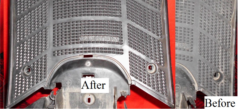

low dollar build low dollar fix
how to get rid of plastic discoloration without painting
tools needed map gas torch and the guts to do it ( don't know if propane gets hot enough
Warnning proceed at own risk try on scrap part first
your basically heating up the top of the plastic
and melting it to get the color back
it isn't perfect but I think it looks better than before

I used Novus plastic cleaner that I got thru Amazon. Worked well for me.

DeanP wrote:I used Novus plastic cleaner that I got thru Amazon. Worked well for me.
to far gone for that notice upper right corner it will get rid some discoloration from bent plastic

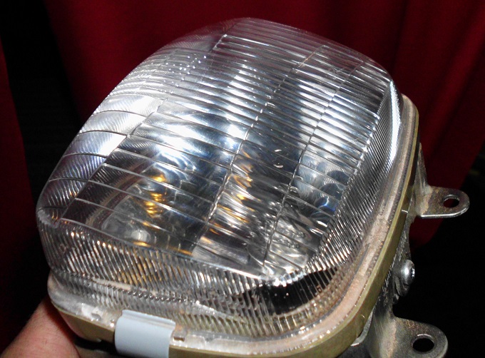

the 2001 head light is plastic
well this one is in really bad shape
see if we can fix it
top right how bad it was
top left some filing and wet sanding
bottom some polish and buffing not bad for first try
will try again
( I do have a sealed 25 watt head light if this dose not come out better)

re sanded
and rebuffed headlight saved now on to turn signals

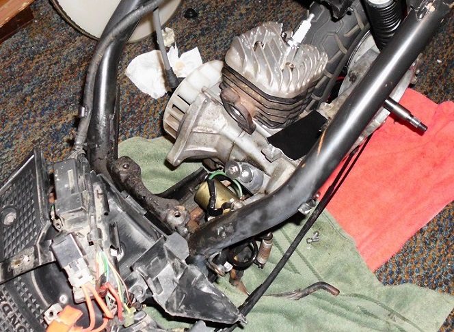

Post by cruzingratiot »
some tape a vaccum and a dremmel a quick port of the intake
the motor is in
need to spend some money :x
don't want to run it without temp guage
so first money spent other than paint & paint supplies
