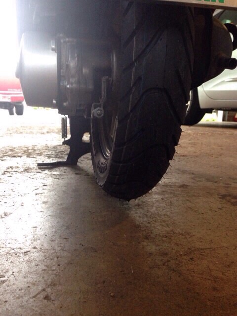

Update:
Just got the new up-size tire installed on the Aero. Tire was a Kenda 413 3.00x10.0 and installed on the rear with stock rim. Pictures shows before and after and side view. Big tire looks great. Everything cleared fine except the valve stem. The tube came with a 90 degree stem and just touched the muffler. Added a couple washers under the mufflers two main bolts and clears fine.
The ride is much better. I am better then 200 LBs and the stock tire would flatten a bit with me ridding. The bigger tire holds the weight much better.
I thought the larger diameter would give a little more speed but no so in my case. Maybe 1/2 mph but not enough to notice.
Thanks again to wheelman and motormike for the info.

Re: Up-size tire from 2.75 x10 to 3.00 x 10
Great looking scoot there...
That tread design and size rides so much better than the vintage tire.
Happy trails...
