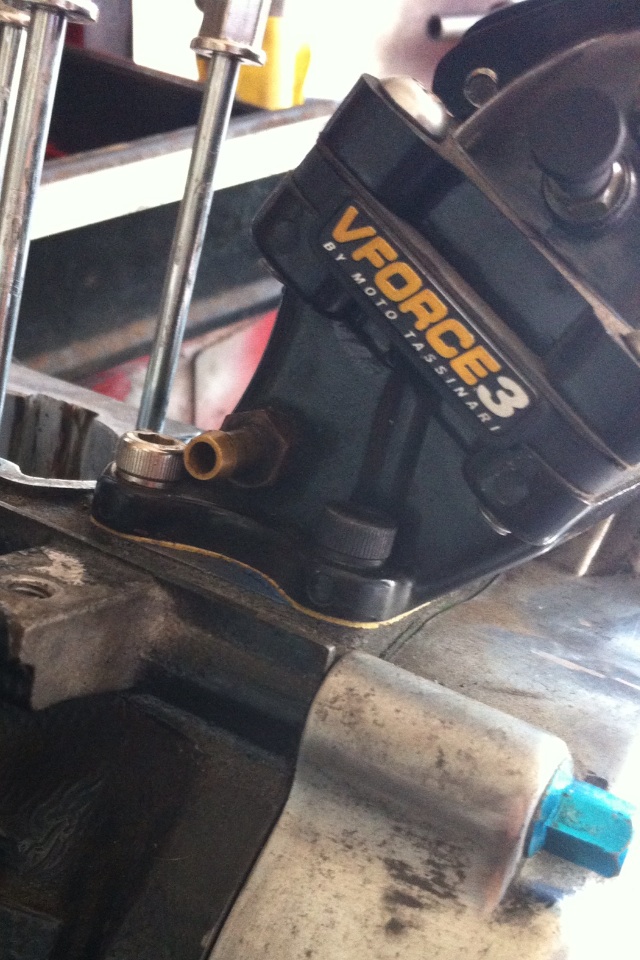

Like this,if you are running a fuel pump ,you need to tap your manifold,like you see
On the picture

i have that on my ct manifold but its not located there on the picture its located at the top can i put tap it there?
Downsouthdio
Posts: 835
Location: Key west
Re: sym dd50 with af16e engine?
Post by Downsouthdio »
Ok,no if you are running a pump,it needs to be where you see it in the pic

Ok so what will I do on the top nipple close it?or leave as it is.
Downsouthdio
Posts: 835
Location: Key west
Close it

do have any idea what size of nipple port and where to buy it thank you..

Downsouthdio wrote:Like this,if you are running a fuel pump ,you need to tap your manifold,like you see
On the picture
Jealous of your reed cage :cry:

chamisataza wrote:do have any idea what size of nipple port and where to buy it thank you..
I would get something similar to the size on your pump?
You can get these brass Barb fittings at any hardware store in the plumbing side. You will also need to get a NPT tap for whatever size you end up going with.
