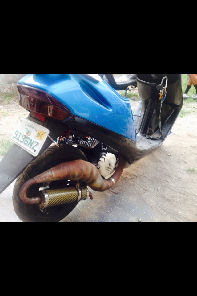

ok guys need some tips.. trying to tune my 72 sparrow exhaust. I've got a 72 corsa mini stroke 28mm carb lightened mag 1500 contra spring, malossi fly clutch with yellows in, 7.4 gearing... I've got 7 and 8s weights in it and it pulls hard... but heard that the lighter the weights for these pipes the better and won't hurt top speed... so to actually know I should mark my pulley and just keep going lighter? Is that how you do it? Right now my tach is only reading 10200.. anyone know the sweet spot for this pipe... thanks in advance

IF your going to lighten or change weights at all,Also think about the way your clutch/Springs work

Well for you,,but i ran sparrow on my previous ministroker,now on my stock stroke corsa,,stock clutch 6 g weights..works great

Also,i dont think many have tried the sparrow..there are many different copies,mine is a scooter alley
- image.jpg (113.66 KiB) Viewed 16569 times

yeah mine is a scooter alley one too... I like it. Its not as loud as a scorpion and pulls really good. I have a scorpion, pg short, and v8 stroker. and I think this pipe is the best all around. The v8 was good for cruising town. The pg short was loud lol. Scorpion was good mid and top. And the sparrow is all around... I will try to mess with the tuning and see what I can do.Downsouthdio wrote:Also,i dont think many have tried the sparrow..there are many different copies,mine is a scooter alley

I felt the same,felt it was a great All around pipe
