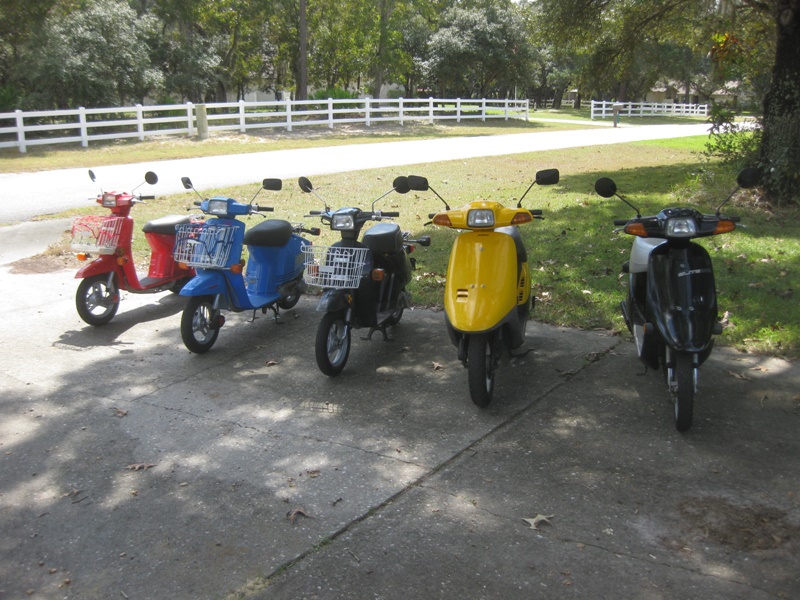

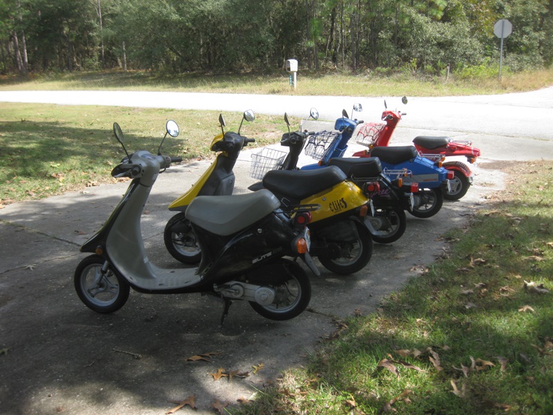

Anyway, here are photos of the fleet I took today:

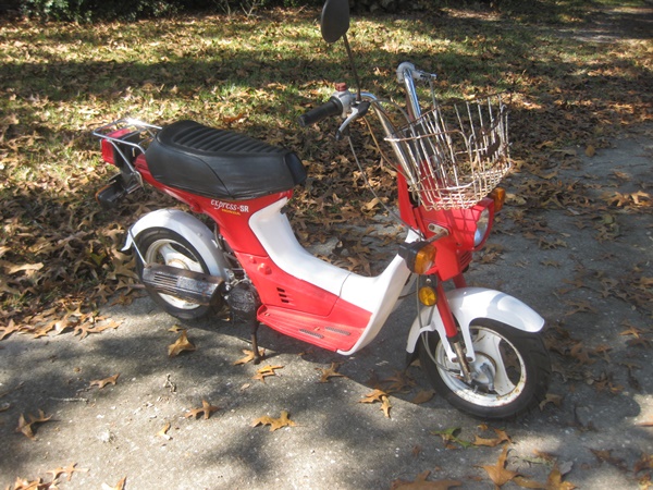

I brought home this Express SR today.. fast approaching double digits.. this is a terrible disease. All I wanted was a pair of Gyros, and somehow I am ending up with one of everything Honda 50.
It is a cute little bugger, but it is missing a lot of parts that a previous owner decided weren't necessary.. I'll post a wanted ad in a separate post.. haven't tried to start it yet..
