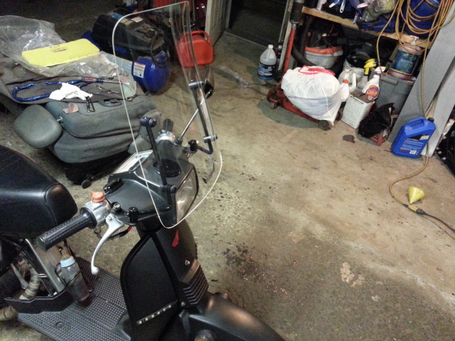

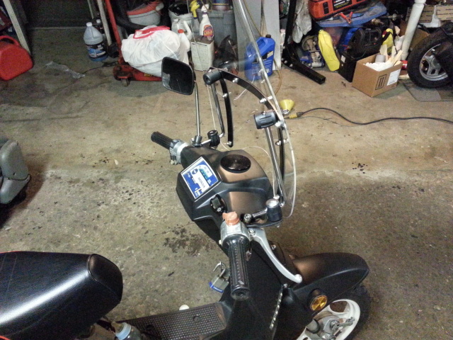

I'm getting ready for cold weather riding so I got a new windshield.
Now motor is overheating with the new windshield on.
What a bummer. It must be the air holding the scooter back?
Putting extra pressure on the motor?
I tried two different styles of windshield but no luck it overheats on high speed rides. :?
Maybe I can up jet?
Any help would be appreciated Thanks

Could you try to change the angle ? Tip the top back to make it more aerodynamic .
Or cut it down and make it smaller ?

I did try a different angle on the other windshield, but no good.
Wheelman I think you're right about the windshield causing drag.
The scooter has slowed down quite a bit. It's pushing a lot of air.
I will have to try a smaller windshield. I don't think it's going to help much when it drops down to 40 Degrees outside?

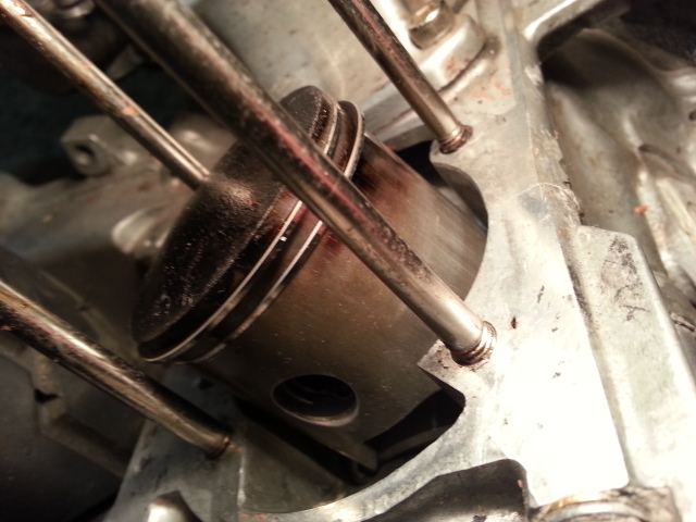

I noticed a little pitting on the top edge of the piston. Does anyone know if I can reuse that piston?
The temperature hit 450 degrees. :sad:
any info would be greatly appreciated thanks.

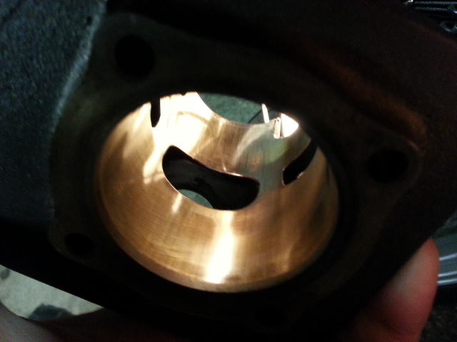

:confused: hi forum.
You really can't see the pitting but you can feel it a little bit. The bore looks good not scraped up.
I was far from home when it really started getting hot. :(
