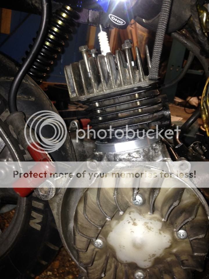

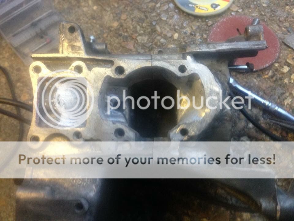

Someone here fitted a 70cc piaggio top end on his 50cc melody and it's a flyer, but he did have to do fair bit of work on the casings for them to match up

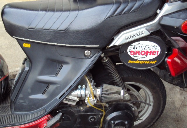

I can report flawless and impressive performance from the Mikuni 24mm flat-slide that I installed on my stock bore Aero 125. The duration of use so far is approximately 8,000 miles. I would repeat this and have no regrets.
The intake manifold is CT...mated to the case with a custom-made adapter plate.

It looked a lot of work, but he sent me pics, he built the cases up with weld, then machined the new ports in them, used a 80 rod for the bigger small end bearing, but as its longer, he made a spacer, and now it's an animal for a little 70 pulling power wheelies

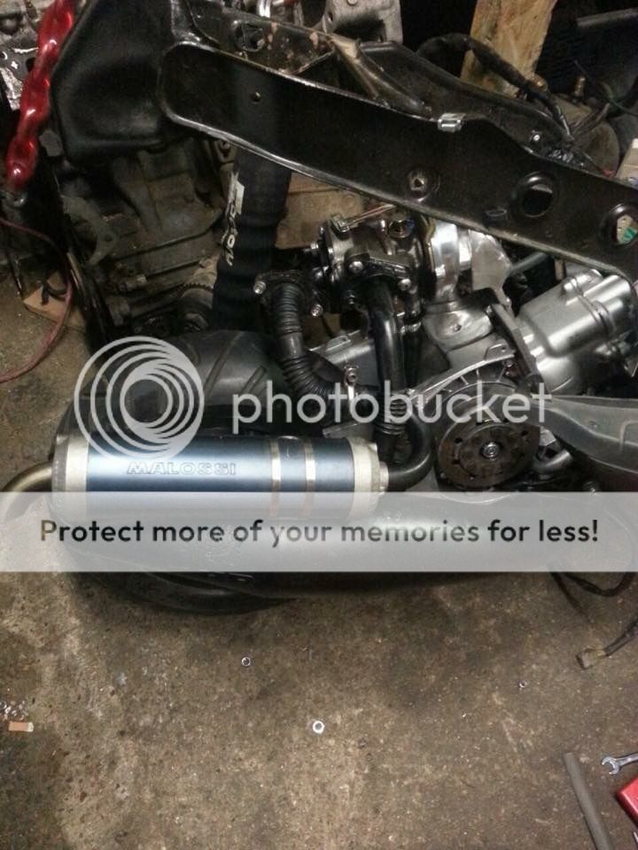

The bottom pic is a 183turbo :-)
