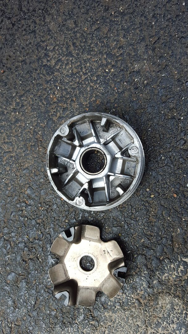

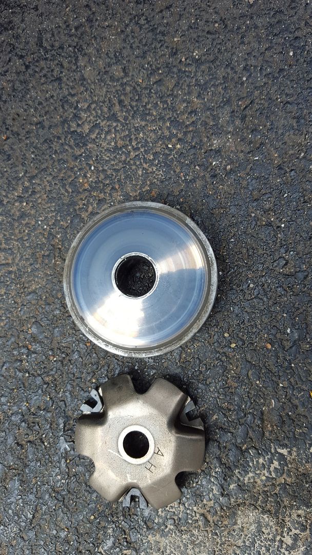

Looks like 9.1 will be my choice. I tore apart inspect make sure it didn't have a variator already. Didn't think it did tops out at 30mph but hey never know. Rollers pretty worn and flat spots. Im not sure if this is stock or not any ideas? Image
bonesv
Posts: 1615
Re: Need little help choosing best gear set for my dio spree
Post by bonesv »
It's stock.
