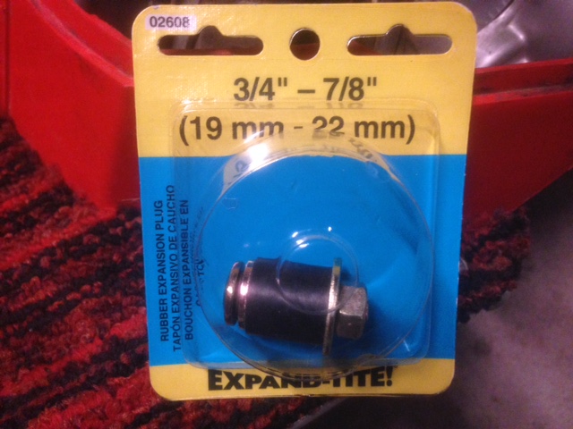

This is what Im looking at from advanced auto parts. Im wanting the upper washer to fit into the recessed part of the oil pump hole and the rubber shaft part to fit into the smaller/lower opening. Does anyone know these dimensions or should I try to measure my openings. It'd be nice if I had a caliper to measure with but I don't..

Those are the exact plugs
I would just measure the hole with a tape measure, should get you close. I bet the 3/4 7/8 plug is the one

Heres what I used for my Oil Pump plug...Bought from Advance Auto Parts for $3.99

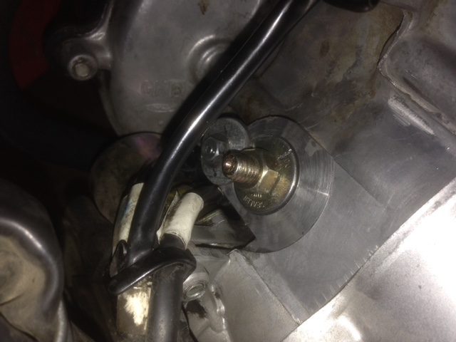

Heres the finished product. The plug would try to work its way out when I tightened it so I used the oil pump mounting bolt and a washer to hold it down. I had to take the washer to a bench grinder and grind away one side to allow for some wiring that was close by. You can also see in the pic that I cut a small notch in the top of the plug washer. This was so I could hold it still with a flathead screwdriver when I tightened it or else it would just spin in the hole. Once it starts to grab, you can tighten it the rest of the way without holding it.
