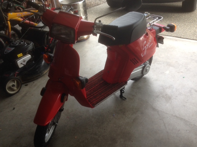

I guess its time to post pics.
- spree3.JPG (99.33 KiB) Viewed 19645 times
- spree2.JPG (106.63 KiB) Viewed 19645 times
- spree1.JPG (109.61 KiB) Viewed 19645 times
Re: Stock Spree with Taz gears..RESULTS!!
Clean! Nice ride
