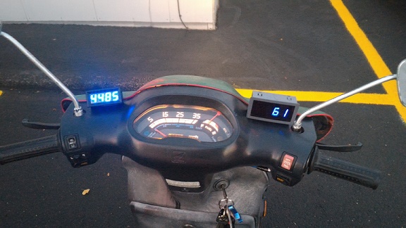

Re: Hardwired Gauges
Thanks vintage, I had it backwards and that solved the problem. Still trying to figure out exactly how i want them mounted but threw this together tonight in about 30 minutes. Gotta say im pretty impressed with the gauges so far, picked up temp gauge and about 8 feet of the cht wire for $16 and tach gauge for $15; love Chinese sellers on ebay/amazon.
- P_20160827_202702.jpg (88.61 KiB) Viewed 3798 times
