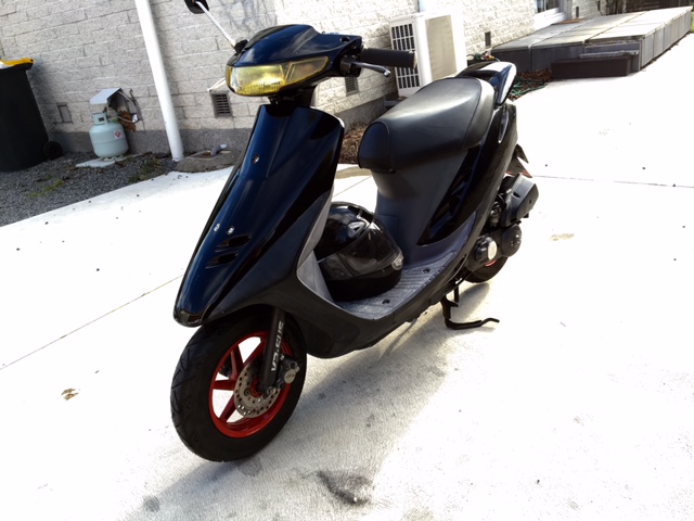

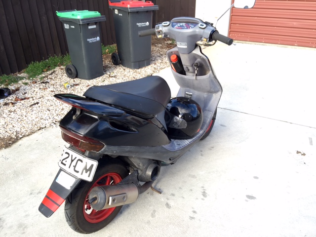

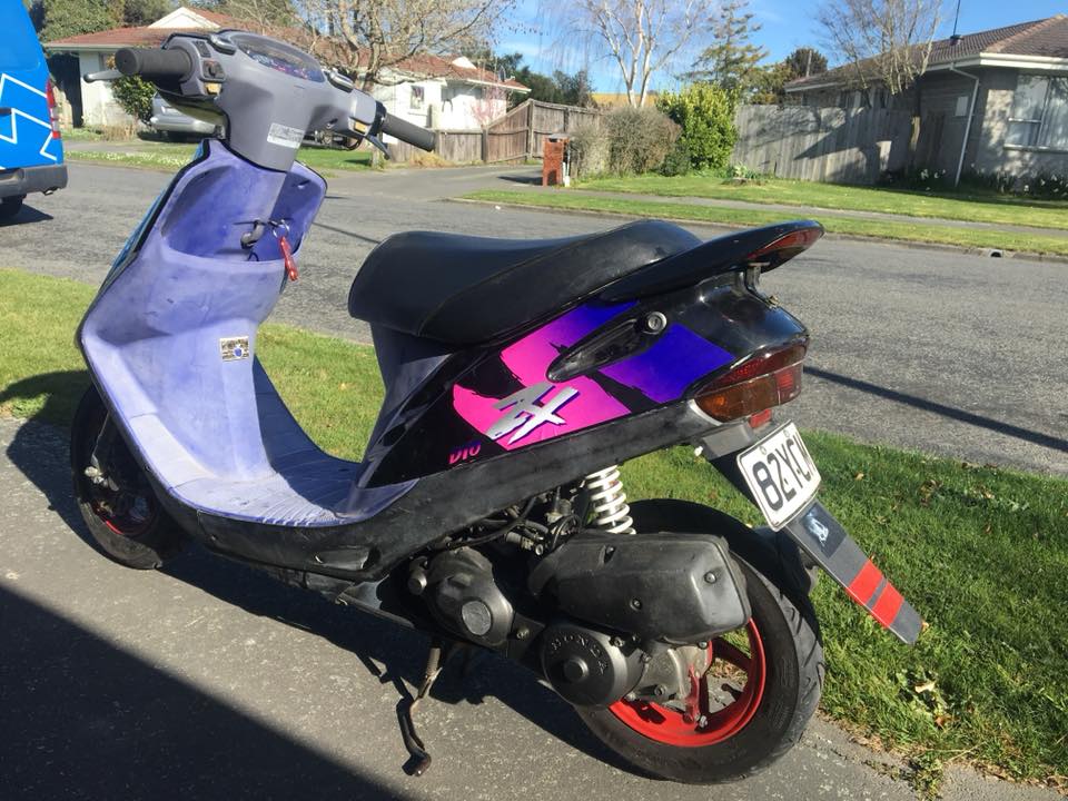

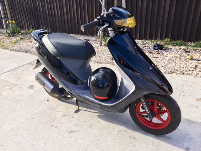

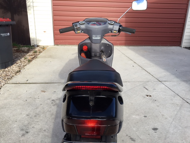

Some pics of my finally finished scooter. I ran into a few issues and it sat in the garage for a few years but the need for a running scooter for a big event, coast to coast (250kms over mountains) sparked my interest in the Dio again.
It started life as a JDM Dio ZX AF28 in japan. Then came to NZ. Kyle (paulpauly on fourm) took the front end and engine for his Nifty fifty. I bought the rest. I had enough parts, including a ZX af18e engine with the good crankshaft, carb etc. So it got put back together as a ZX dio.
Just out of interest we did measure this ZX and a standard dio and the ZX does have a slightly longer wheelbase.
Kyle put the bike together the first time. We just bolted on the Malossi cast 72cc bore. While I was riding it to break it in the original bearings well and truly shat themselves. After that it got the new bearings and seals. Kyle also did a mild port job. It has the standard carb and a GOSHI Honda pipe. I wanted it to look stock (for the law side of things) but be quick. The black plastics aren't in great condition with a few scratches but have polished up nice enough for a day runner scooter.
Speed wise. I've seen 80kmh but its most comfortable at 75kmh. Its got great acceleration and starts and runs like a standard Dio. I think that's beauty of having the cast kit for a daily runner bike. Kyle also managed to get his hands on an uprated oil pump from japan. With that installed there is no need to premix. Just fill her up and go.
So what has been done:
Engine:
Genuine Honda bearings and seals.
Up jetted factory carb
Malossi Variator and belt
I put new gears in but cant remember the ratio.
Malossi Cast Iron bore 72cc
Exterior
Standard dio ZX with the rear 'wing/spoiler"
I bought the alloy wheels. Media blasted them and had them painted
3.00x10" ContiTwist tyres at 35psi (probably going to drop to 32psi)
NCY throttle and grips (so nice to use, very comfortable and easy action)
120kmh speedo
TTO temp gauge and rev counter
I changed all dress up fairings to grey. I didn't like the old purple and mish mash stuff it came with. I like the tougher look of black grey with red wheels.
Anyway, I will let the pictures do the talking.

- Honda ZX Dio (3).JPG (123.93 KiB) Viewed 64228 times
- Honda ZX Dio (2).JPG (114.23 KiB) Viewed 64228 times
- Honda ZX Dio (1).jpg (144.29 KiB) Viewed 64228 times

- Honda ZX Dio (6).JPG (104.29 KiB) Viewed 64227 times
- Honda ZX Dio (5).JPG (125.63 KiB) Viewed 64227 times
- Honda ZX Dio (4).JPG (127.33 KiB) Viewed 64227 times

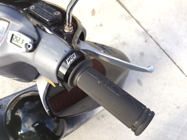

Re: JDM Honda DIo ZX with Malossi Cast 72cc.
NICE!

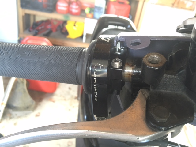

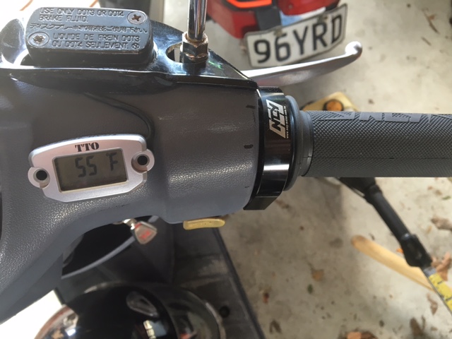

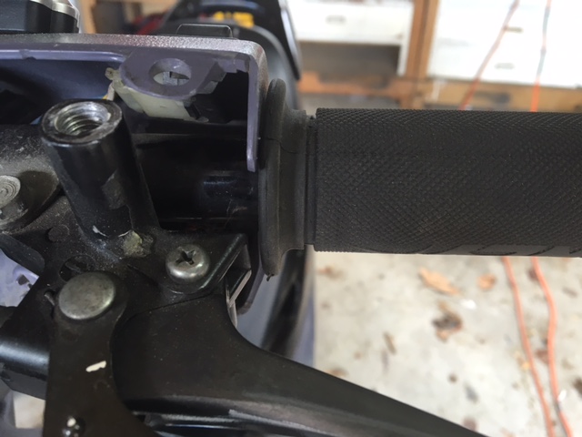

Can you tell us a little more about the NCY throttle?
--Shortens up the throttle travel?
--Does it mounts right onto the SuperDio handlebars without having to cut into the headlight or speedometer plastics?
Thanks!
Thanks!
'92 Super Dio ZX - AF18 Corsa
Hi Melo, I'm in New Zealand. We have very different laws to the USA. It is relatively easy to register our vehicles here. However, there are rules about mopeds and scooters so hence the need to keep it looking stock.Meloshameless wrote:Its bee you tee full! I understand it looking stock for "the law side of things". But im just curious how you got that titled over here.
Honda DJ1R project
Honda DJ1R project

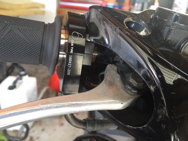

The NCY throttle is super nice and an easy install. It shortens the twist movement but more importantly the grips are bigger and the needle bearings make it really smooth. Overall it makes for a much more comfortable ride. You also get amatching grip for the other side. These are physically a bigger diameter than the standard throttle and grips.S4Patrick wrote:NICE!
Thanks!
Install is easy. Remove the headset plastics. remove old throttle and grip. Use the standard Dio throttle cable. Install the new NCY throttle. No need to cut the plastics or anything. It takes a bit of mucking around and trial and error to get the grip in the right place but it slides in and has plenty of room around it. The plastics butt up against the throttle and hide the screws. All in all a very clean install. I bought it from Scooter Swap Shop. As always he was very helpful and great to deal with even on the other side of the world! Make sure you support him and buy it off him when the time comes.
- Honda Dio ZX NCY throttle (3).JPG (96.37 KiB) Viewed 64123 times
- Honda Dio ZX NCY throttle (2).JPG (92.26 KiB) Viewed 64123 times
- Honda Dio ZX NCY throttle (1).JPG (96.91 KiB) Viewed 64123 times

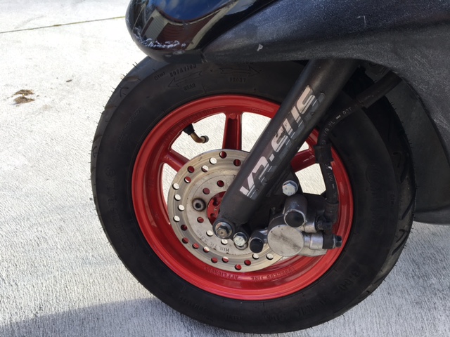

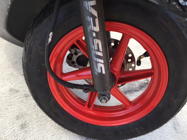

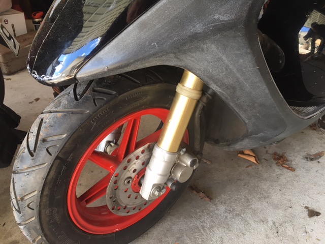

I also replaced the front forks with the gold coloured forks that came with my dio alloy wheels. It looks way better. I'm not sure if they are better forks? They seem beefier than the standard disk forks? Anyway, they complete the picture.

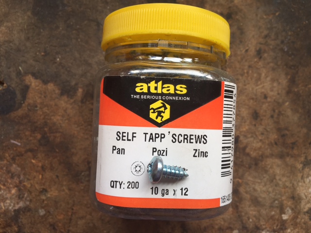

Something else I did while sorting out plastics was to use some over sized self tapping screws from the hardware store. They look great and work well to keep the panels installed and tight.
