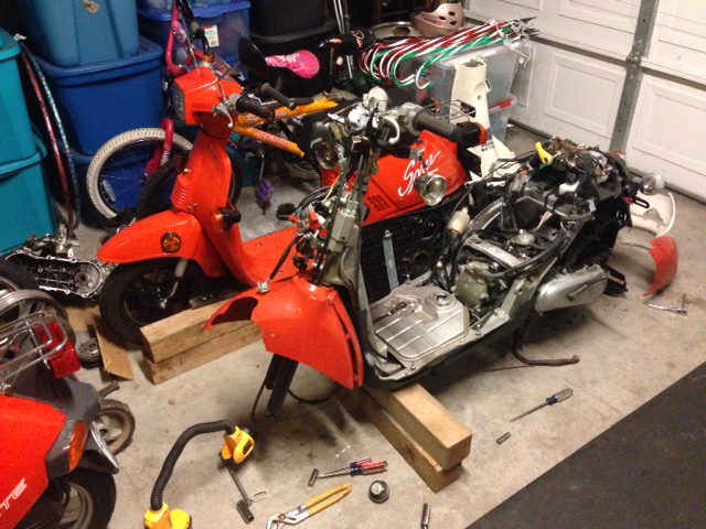

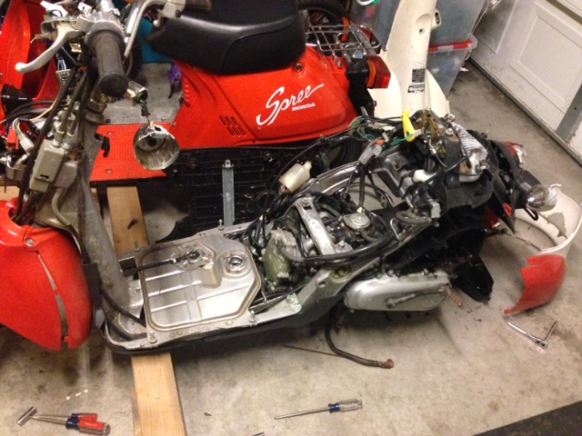

OK, the met-spree swap is not happening. The mounts are completely different. Youd have to perform miracles to get it to hook up. I now have an 06' Met in the garage and its in the tear-down phase. This is a totally different animal than the 80's-90's Sprees and Elites. I have my work cut-out for me to get it going.

Im gonna need a Red Bull for this one....
- met1.JPG (158.53 KiB) Viewed 12958 times
- met2.JPG (146.73 KiB) Viewed 12958 times
Re: Anyone do a Metro motor swap into a Spree?
For those that haven't had much experience on a Met (me) the bolt you see just below the cross member is the motor mount point. Im still trying to figure out the braking system, how you pull one handbrake and it squeezes both front/rear brakes but the other handbrake only pulls one. If anyone has a link to the Service Manual for the CHF50 Id really be grateful.

Off topic question, was the bike wrecked really bad causing it to be a parts bike? If you you need to break it down more and inspect welds to be safe. Also thats not too bad pretty together still.

The bike definitely spent some time horizontal on both sides. Plastics are trashed as well as turn signals, brake levers, etc. I look past all that surface damage and see a decent bike underneath. Once I assess the cost of all parts needed to get this back together, I'll make the decision on whether its worth making that journey.
Still need to drain all the fluids from the motor, coolant system and fuel tank and replace with fresh. Get new plug and air filter. Add battery then hard-wire the ignition and see if she'll crank.
This being a 2006, its old AND new enough that theres plenty of used parts out there and everything is still available from Honda.
Not sure how the powers that be feel about a Metro thread lingering around the site. I really wasn't looking to buy one when I bought it but I figured Id give it a shot since I got it for almost nothing.
