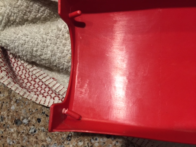

Overall, the plastics on my spree are in really good shape. just a couple of very small cracks. Luckily, I work at a polyethylene pipe manufacturer and have access to an extrusion welder. I will try to make this work to repair the small cracks. Can I get some advice on how to repair several small pcs of the body that have broken? things like the in the picture. these are the small pegs on the front cover.

Try U-POL STRONGHOLD 706
https://www.amazon.com/dp/B002M0R900
Goop it on around the busted tabs, sand if needed.
It should work for most all plastics problems. The peg in the image though, looks to be real bad, kind of hard to tell from the picture. It should work for you though. If not, you're gonna have to buy a new one. Fortunately, you can get those pretty cheap on eBay. Probably find quite a few on here who have one to spare as well.

Those parts, you have two options:
1) Try to fix the peg and glue in place. You can reinforce with epoxy putty since it's not a show surface.
2) Replace plastic pin with same size metal pin. A machine screw threaded through hole where peg used to be should hold, esp if you glue threads in with epoxy.
Predict that #1 won't hold, so do #2.

I would just jb weld it, that panal dosnt take much force unless your hitting a tree, so dont hit trees and your good.

Another way to fix plastics is to drill a small hole through the pin and another through the panel. Find a small nail or other item to make a pin (a small brad works well). Liberally coat both pins with Super Glue, coat both plastic parts liberally, and glue back together with pin in panel and inserted into the post.
Gives the post much more strength. I would gob up with JB Weld since it does not show.
