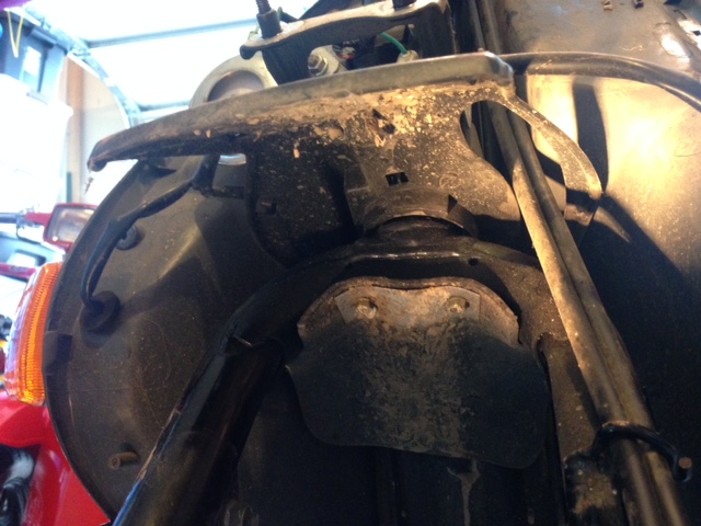

The first pic shows the plastic shroud I mentioned earlier. That will need to be hogged out for sure. The turning stops on the stock stem are small and fit inside the shroud but the stops on the Met stem are large pegs that protrude from the top. See pic.

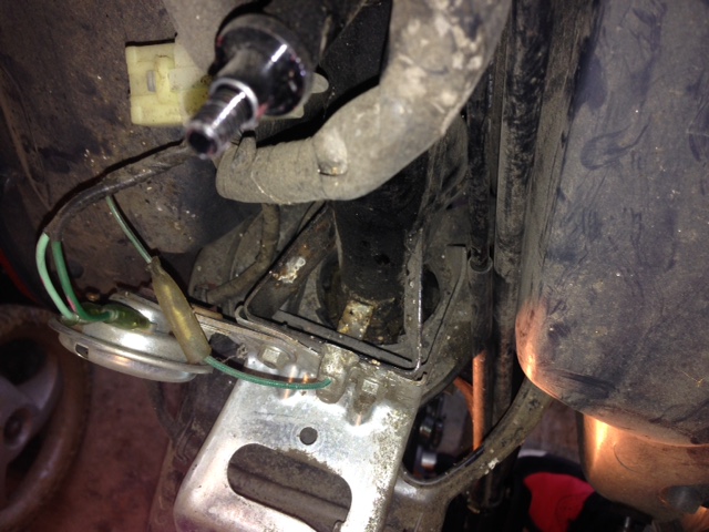

The other pic shows top view of stock lower bearing cup. Its buried in plastic shroud. Theres a triangle shaped bracket welded to the frame which creates the mount for the nose plastic but inside that triangle, youll see a nub in the middle. That's what the turning stops will make contact with when turning full right/left. Im hoping the met stem pegs and that nub play nicely together.

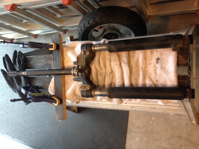

I made some progress on the Met tree swap today. I would've gotten more done but I decided to completely tear down the legs and clean/re-grease them before I started. Heres a pic of the test fit.
