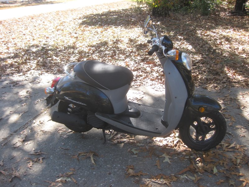

I couldn't resist this 2008 "Gothic" Metropolitan on craigslist last week, even though I have no more room in the shop... have 14 Honda 50 CC scooters now, all titled, registered and running. This is my first 4-stroke.. so the disease has now spread over to the dark side. Worked this weekend cleaning it up and getting it running as new.. 40 mph is effortless, and it's hard not to like it. I have a factory rear rack and front basket on order.. it will be pretty sweet, once it is properly basketized..

Nice find. 2005 and earlier are best avoided, as apparently they had engine breather problems causing a need for more-frequent oil changes or the risk of main bearing failure. That was all sorted out by 2008. Carbureted but liquid-cooled, it's a nice engine.
A 2004 I rode clearly had the power to go faster, but there was a SPEED (Not Engine RPM) limiter that pooped on the party at exactly 70KPH, or about 42 MPH. I never tried disconnecting the speedometer...

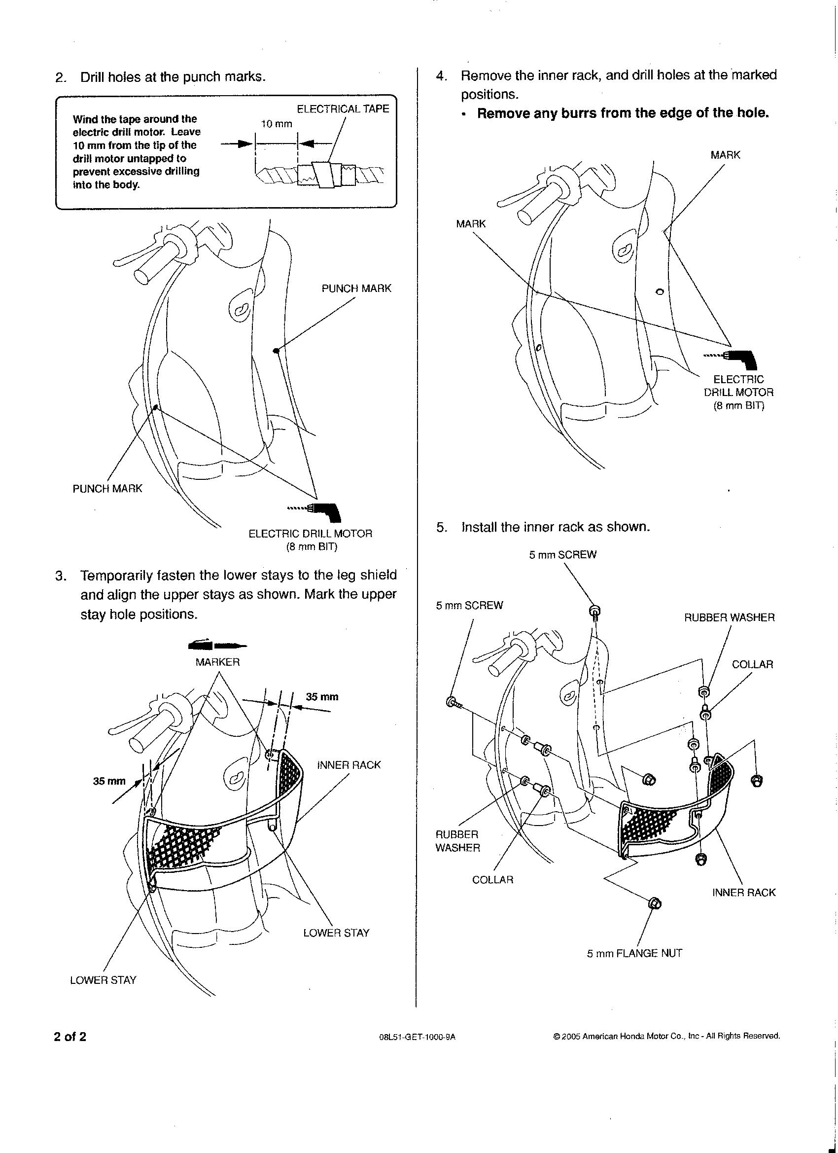

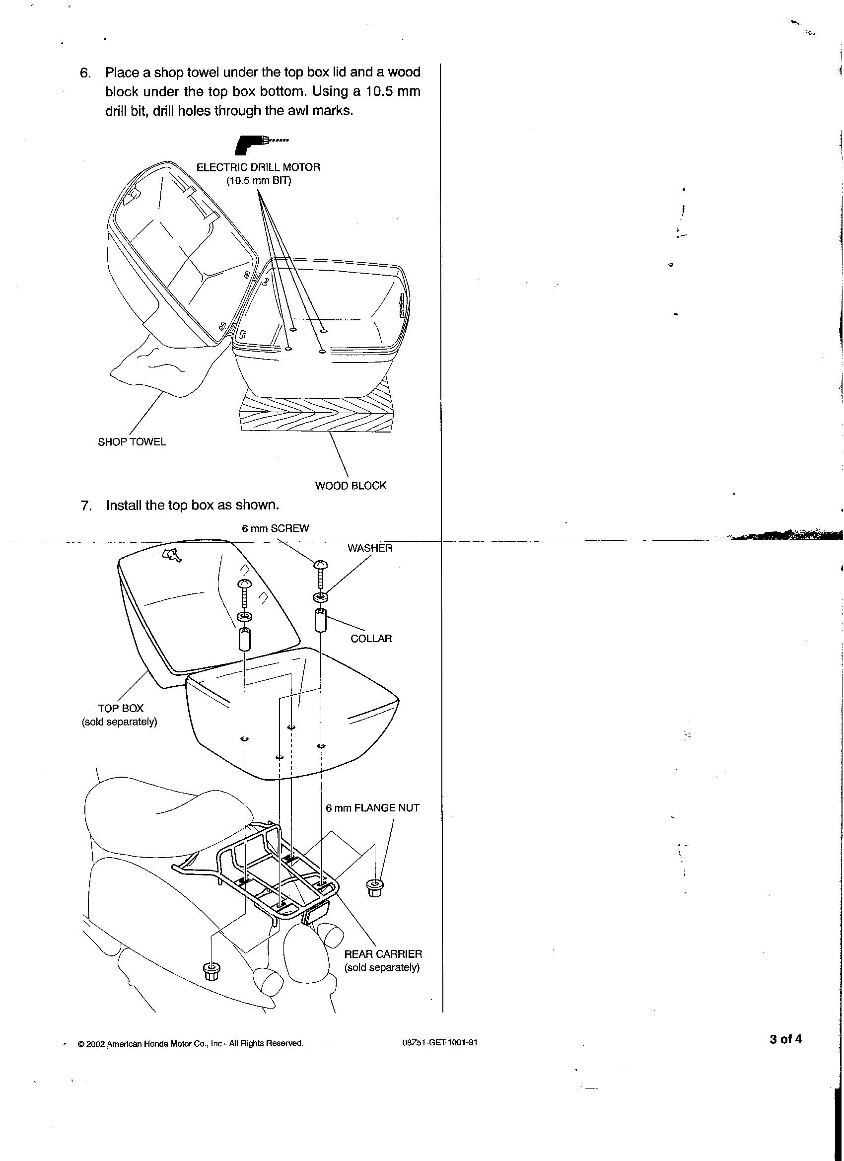

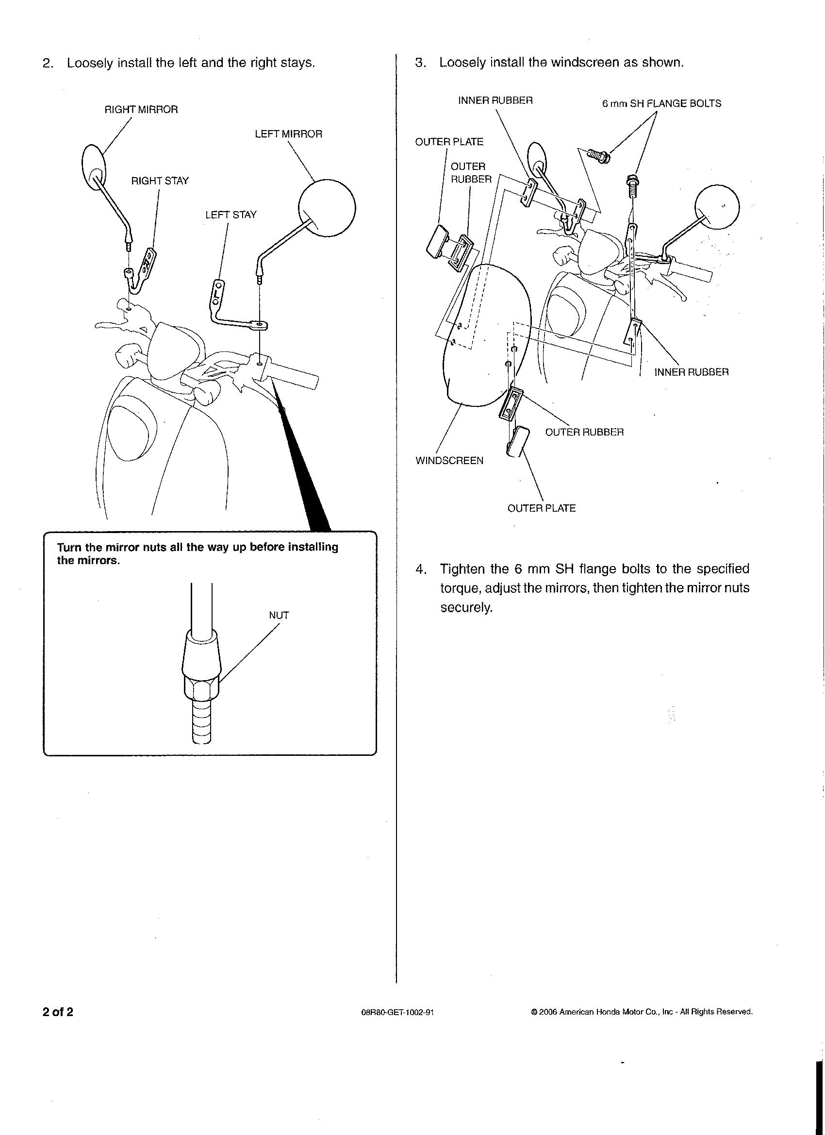

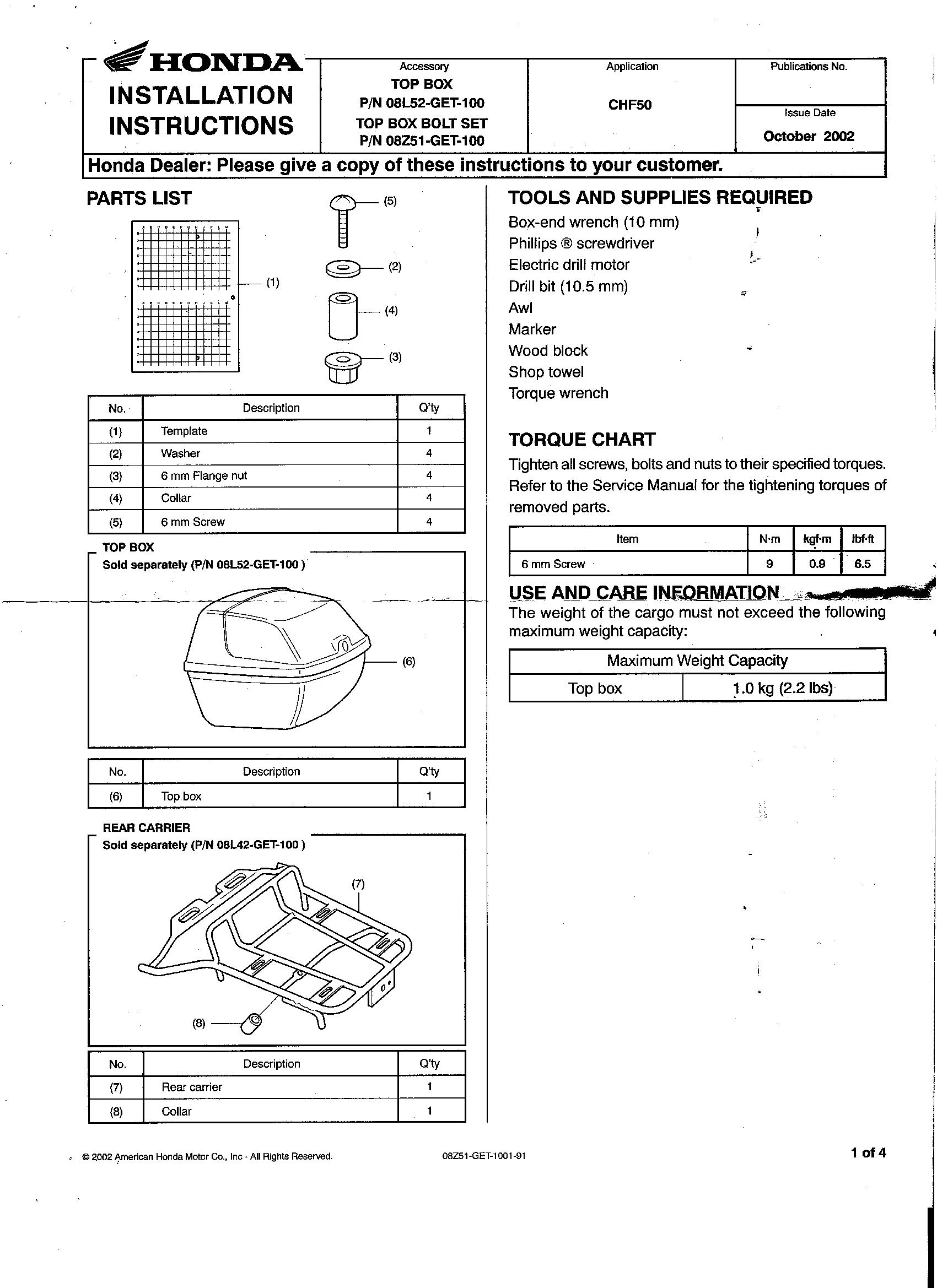

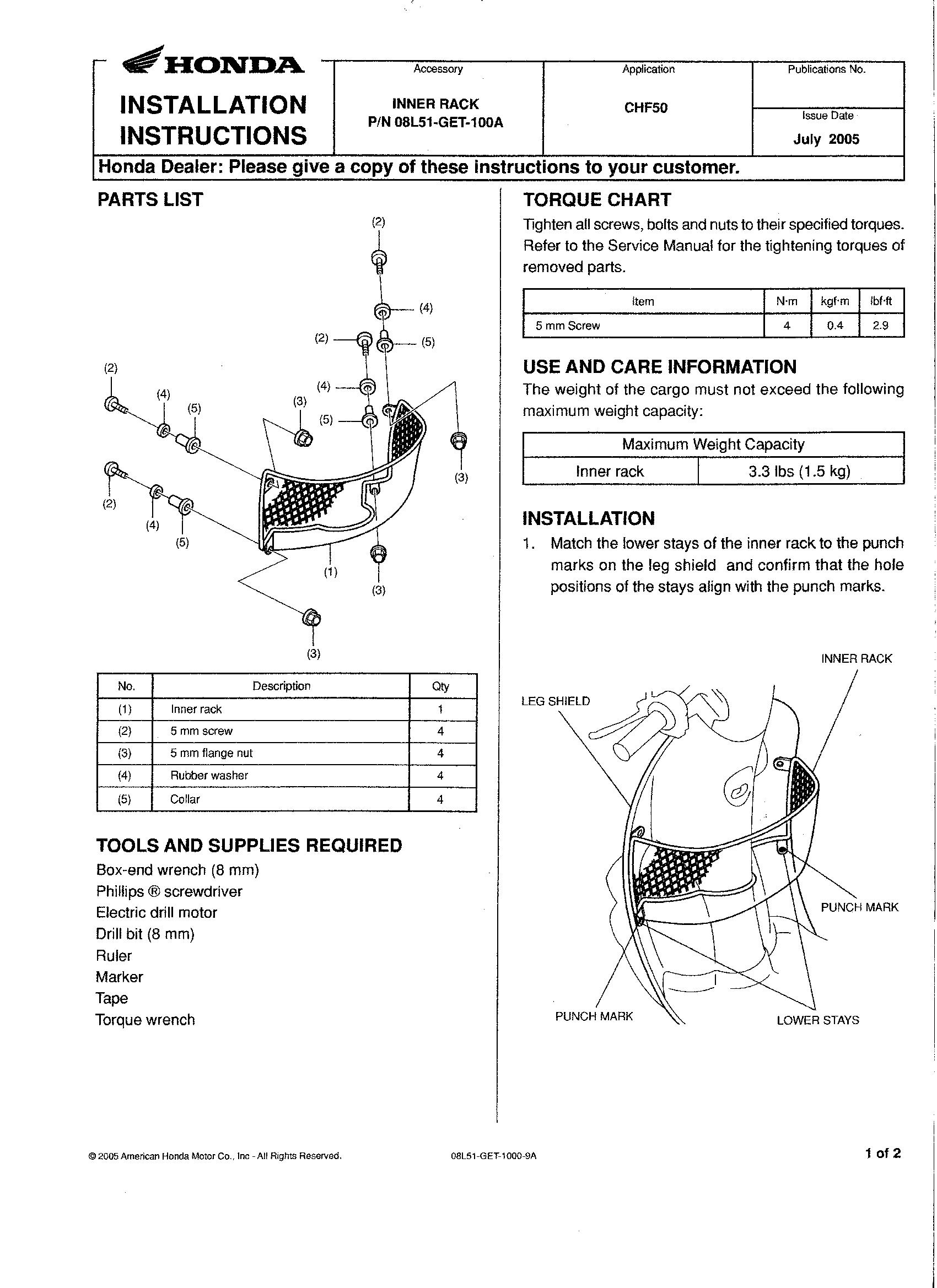

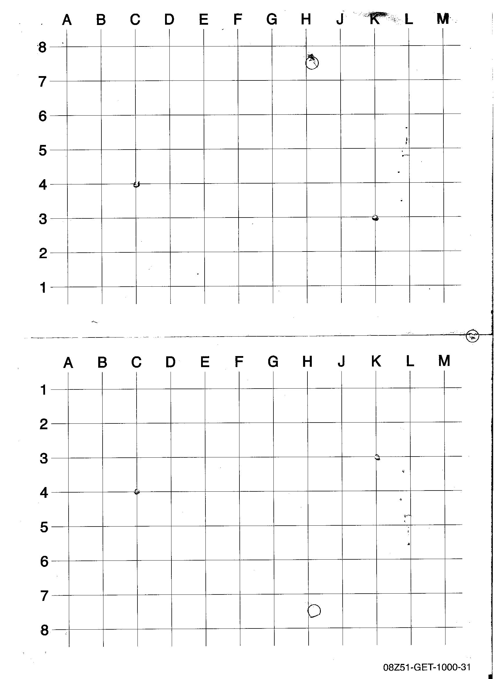

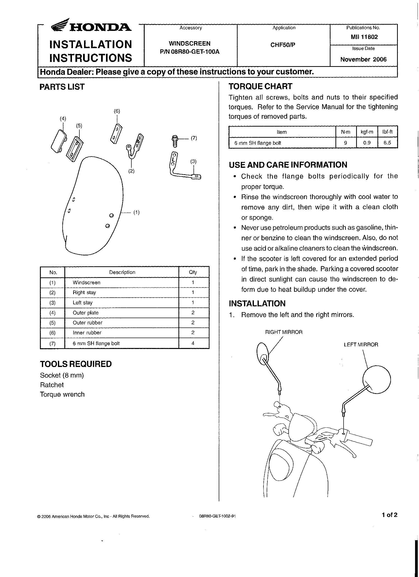

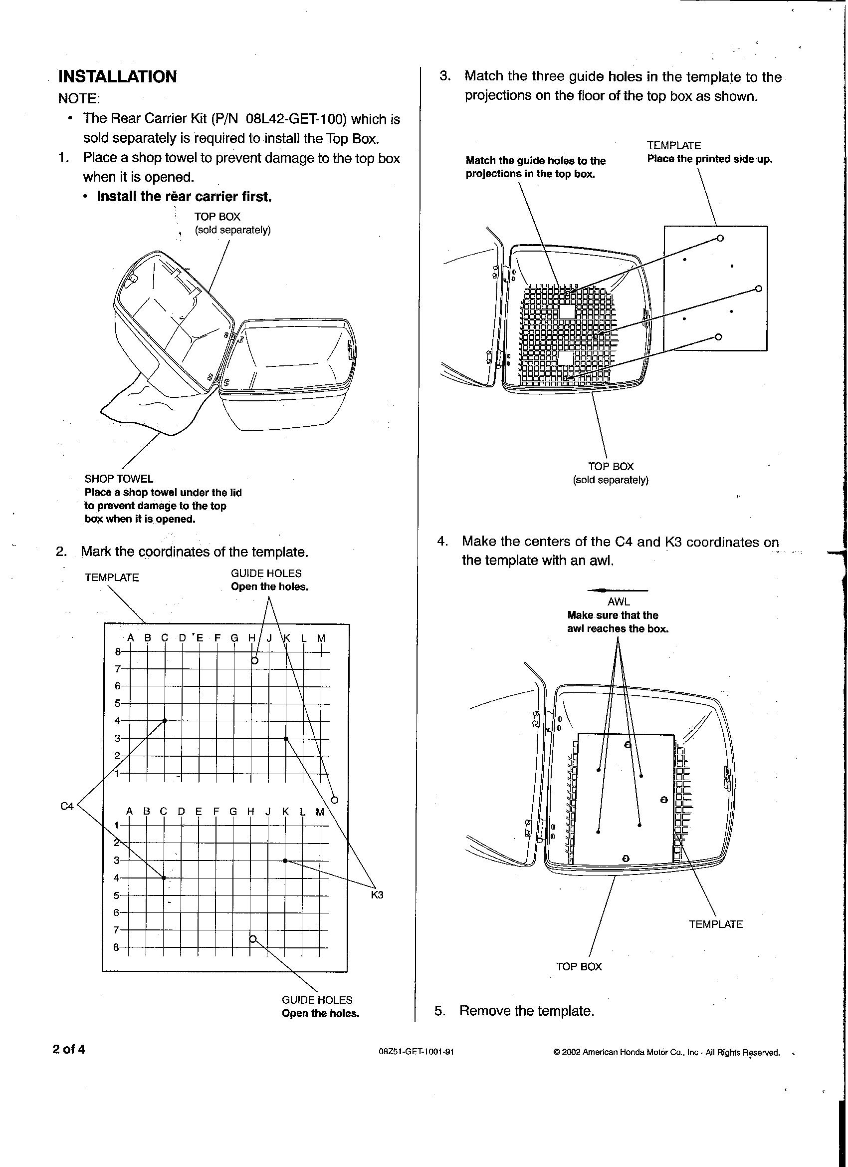

It's now a couple of weeks later, and I have finished basketizing and dressing out the Metropolitan. All of the accessories are still available new from Honda Powersports. I spent a few hours googling and binging looking for the installation instructions for the windshield with no success, so I uploaded all of the installation instructions for the basket, the windshield and the storage box here so others in can look at them before buying the accessories.
As a special note to those contemplating installing a windshield, I am not sure I will leave mine on the scooter. You would think it would reduce wind noise, but it is just the opposite. The wind noise is dramatically increased to the point of being uncomfortable with the windshield installed. I can eliminate some of the wind buffeting by raising my head uncomfortably high, so if you are a taller rider, this might not be a problem for you. I am 5'7" tall. Also, in spite of various comments on other sites on the interweb, the windshield has no effect on top speed. Max speed is unchanged at 42 mph on the level or on a steep downhill, so it may be that the scooter is rev limited at 42 mph as suspected. I haven't been able to find any Honda documentation to confirm this.
Basket (actually called the Inner Rack) - Part number 08L51-GET-100A
Page 1 of the Installation instructions: http://www.vintagegarage.com/BasketPage1.jpeg
Page 2 of the Installation instructions: http://www.vintagegarage.com/BasketPage2.jpeg
Windshield - Part number 08R80-GET-100A
Page 1 of the Installation instructions: http://www.vintagegarage.com/WindshieldPage1.jpeg
Page 2 of the Installation instructions: http://www.vintagegarage.com/WindshieldPage2.jpeg
Rear Trunk (actually called the Top Box) - Part number 08L52-GET-110
Rear Trunk mounting hardware kit - Part number 08Z51-GET-100
Chrome Rear rack (required to mount the Rear Trunk) - Part number 08L42-GET-100
Page 1 of the Installation instructions: http://www.vintagegarage.com/StorageBoxPage1.jpeg
Page 2 of the Installation instructions: http://www.vintagegarage.com/StorageBoxPage2.jpeg
Page 3 of the Installation instructions: http://www.vintagegarage.com/StorageBoxPage3.jpeg
Page 4 of the Installation instructions intentionally blank.
Drilling Template: http://www.vintagegarage.com/StorageBoxTemplate.jpeg
