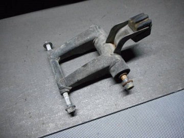

I'm using a DJ-1 motor mount for my engine swap project since I couldn't find an Elite mount.
http://www.ebay.com/itm/282236964781
Part number: 50350-GR1-880

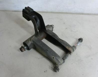

Thanks for the info. Anyone know if a sa50 and se50 engine mount are the same?
Re: Which engine mount to put a variated af05e in a Spree?
Posted: Sat Feb 25, 2017 12:10 pm
by bonesv
This is the info I have gathered.......the se50 has a shorter "neck" on the tang. The early sa50's is taller and needs to be chopped and rewelded to fit into the spree frame. Please correct me if this is not true.
Posted: Sat Feb 25, 2017 1:07 pm
by Meatball
bonesv wrote:the se50 has a shorter "neck" on the tang. The early sa50's is taller and needs to be chopped and rewelded to fit into the spree frame.
Bones knows his shizz. If that "tang" doesn't go into the frame hole, youre screwed. The taller sa50 mount just wont go without some chop/weld action. Its certainly do-able if you have the welding skilz to get er done!
Posted: Sat Feb 25, 2017 1:22 pm
by Meatball
The wiki shows one cut being flush-ish with the arm of the mount. However, if you look close at the picture above you'll see that the cut is about 1/4 inch away. Thus, leaving behind the weld bead on the arm. If you were to cut it flush, the weld would be gone and its integrity would be severely compromised.
The cut on the opposite side of the mount is very small. All that needed to be removed from mine was the small protruding center sleeve that the bolt slides into. I supposed you could describe it as just removing the "nipple" sticking out. No cutting was needed on the outer/larger barrel.
