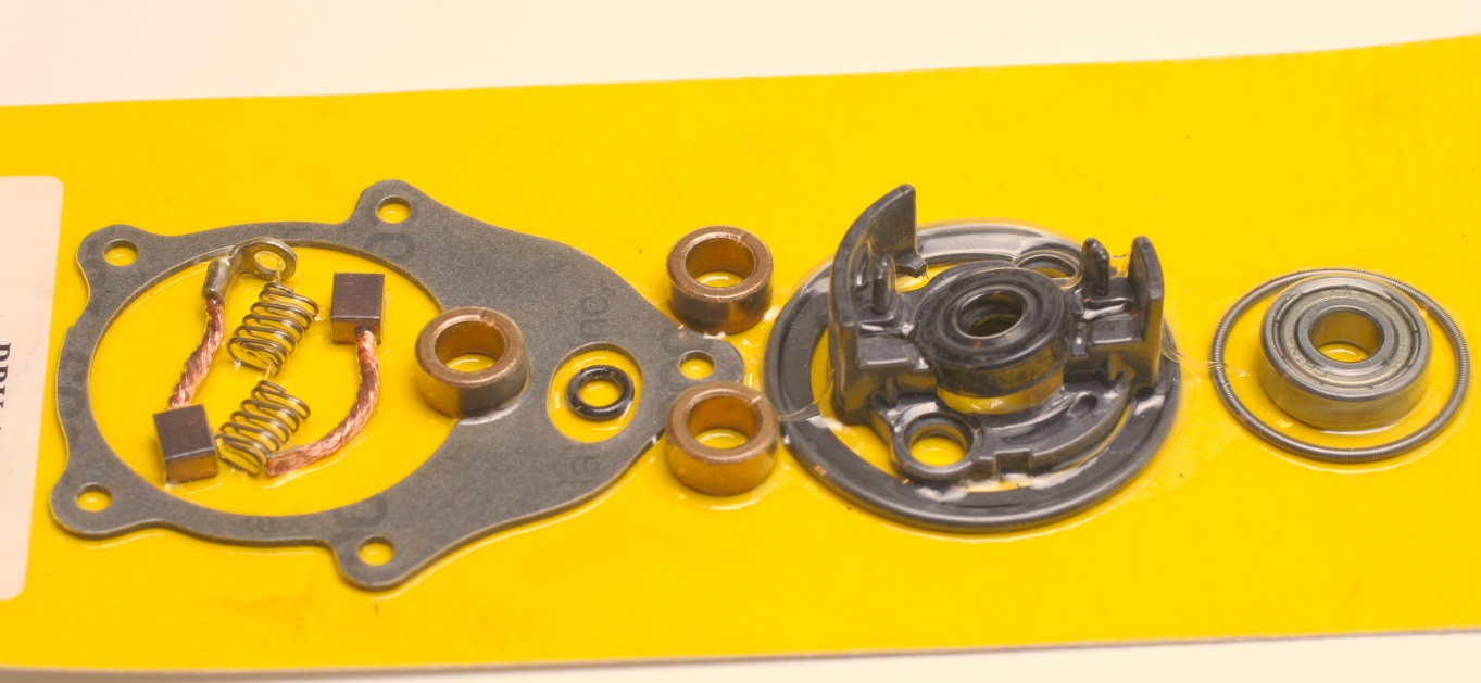

One thing is for sure, mousewheels knows his stuff. If he says it, I believe it to be golden. Ive personally never changed brushes in a starter motor but I have with great success in power tools like drills, saws and even a shop vac once. As far as the LT80 brushes go, this is the cheapest I found with minimal serching effort. http://www.ebay.com/itm/new-for-Suzuki- ... gw&vxp=mtr
If you buy these (or other LT80 brushes) and install them, please reply back with the results and possibly pics/instructions of the process. Thx.

I'd be interested to know if the LT80 brushes fit too. On this side of the pond, they are available as part of the LT80 kit, shame the rest of it is apparently the wrong parts. A few months ago I changed the brushes on may car's starter, the difference in cold weather was like night and day. Many people simply swap out the starter, but it's only an extra 30 mins to change the brushes.

The LT-80 brush as well as most all parts in the LT-80 starter rebuild kit fit. Folks have been re-building their starters for years with these parts :)
For the LT-80 rebuild kit, the following parts can be used:
  • Brushes
    Springs
    Brush holder
    Ball Bearing
    Bushing
