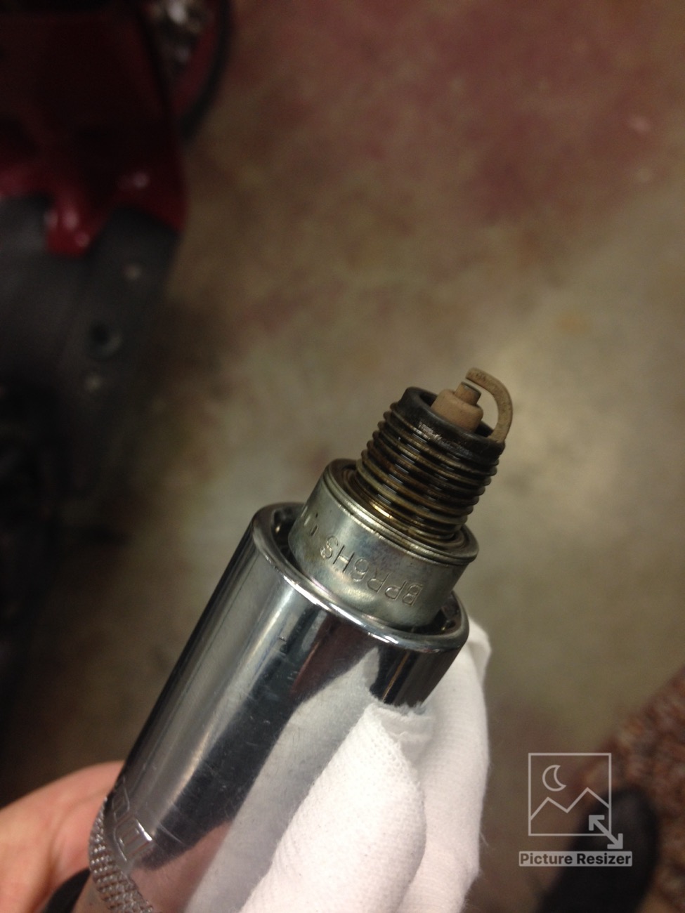

Best possible plug reading I could get was WOT and darn near doing a front flip after killing the engine and slamming both breaks, should my color be slightly darker or is this fine?

That plug looks good to me. You could be more confident with a CHT gauge giving real-time feedback.

I'm assuming you're still using the pump. Do this... order a #80 main jet and swap that into it, then run it at 96:1 in the tank (with pump). You are probably way too rich on the fuel which is why the mix screw does nothing. After a swap, you can set that needle back to normal and you should be just right for your mix at about 1 and 7/8ths turns out. Plug looks good, but you want it a bit leaner oil on acceleration for a better take off then enriched at higher throttle
