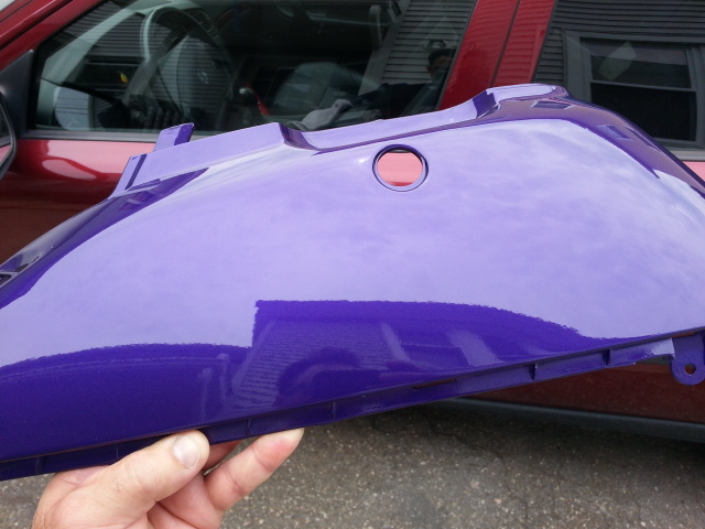

Hi forum.
Painted some panels for a friend here's a paint code may help if someone's doing the same?
ped
Posts: 1598
Location: northeast usa
Re: painted some panels purple.
Post by ped »
:thumbwink: the paint and clear was about a $100. bucks.
I know that's a little steep but this is automotive paint. Not cheap.
4 coats of paint, 3 coats of clear.
yes I painted them in this Dusty garage. just make sure you wet the floor to keep the dust down. I did get a couple specks of dust that I will wet sand and buff out. the cleaner the area the better your paint will come out. Good luck. :thumbwink:

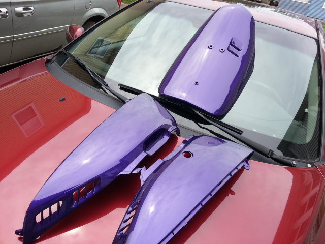

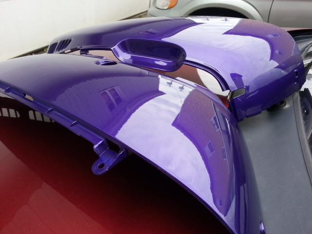

More photos :coolcruise:
ped
Posts: 1598
Post by ped »
For best results take your time when you're painting. Paint on a warm day. spray nice and even. keep an eye on how smooth you paint. Use multiple coats . dust is everywhere it's going to get on the paint. don't worry too much, you can always wet sand with 2000 grit ,and buff later. Good luck.
