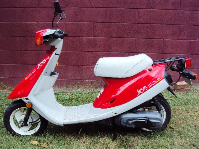

I just bought this '93 Jog Artistic Spec.
It is doing the same thing.
The carb has already been cleaned to get it to a running status.
Runs great for a block, then no gas for a few seconds.
I suspect two things.
Collapsed, deteriorated fuel hose,
and / or debris in bottom of tank or in petcock.
Try those two while you have it taken apart.
And, of course, clean that carb... :urban:
