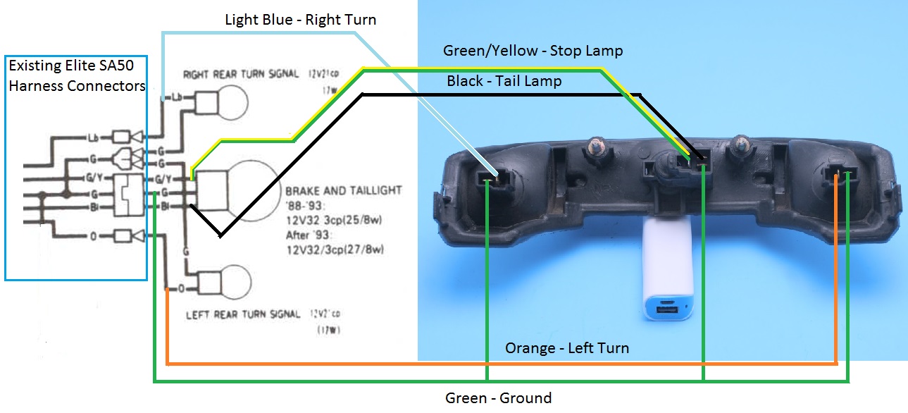

I've been trying to find a wiring diagram for this taillight online and on here. I watched the video on how to wire it, but it's hard to see the diagram.

The 'wiki has a marked up photo member DAC made showing the wire connections by color.
Link Click me!

I just finised a wiring oriented diagram of DAC's photo to add to the wiki.
1610 copy.jpg (111.82 KiB) Viewed 5884 times
JDM tail light wire diagram.jpg (54.79 KiB) Viewed 5884 times
I use these insulated female blade connectors from auto parts store and if you just clip the very end off the elite bulbs' wires and splice onto them, they will be long enough to reach. Cut them carelessly and they will be too short! I use a small piece of heat-shrink tubing to seal over the crimp area.
