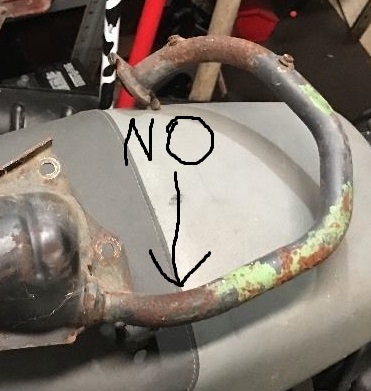

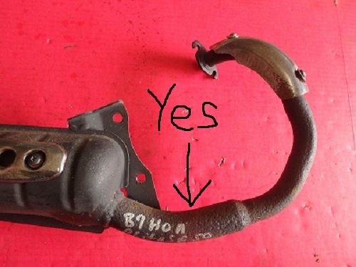

On some of our early (US) Elites, there was no "removable" exhaust restriction washer. The restriction was the design and the only way to de-restrict was to get an entirely different exhaust. It can easily be seen by the bulge of the header tube below....I honestly dont know about VISION exhaust restrictions, but keep in mind that "no exhaust washer" does not necessarily mean there is no design restrictions.

My UK pipe is somehow between the 2 pictures, there's a bulge at the end of the pipe but it's not so long as the unrestricted. I need & want to keep things looking standard on the outside so the exhaust has to stay. Gurtner jets are readily available here so I can get an #88 jet for not much money, worst that'll happen is it won't go any faster but may smoke a bit more.
