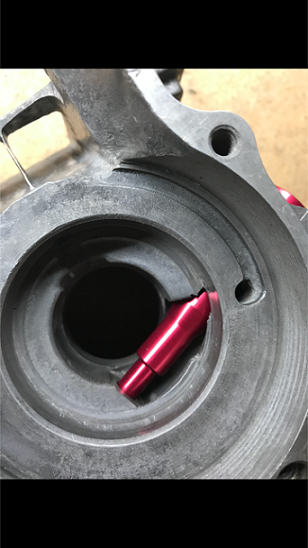

First pic is of the untouched boost port with a Corsa base gasket. Next pic shows it with the stroker bore's base gasket with port work.
image1 (6).PNG (252.67 KiB) Viewed 16577 times

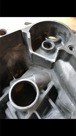

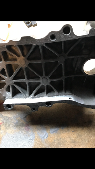

This will have a ZX trans so more cutting is needed. Grind out a couple bumps around the clutch area and belt travel zone. It might be too much but its better than not enough and shred belts.
image4 (1).PNG (226.56 KiB) Viewed 16576 times
image1 (2).PNG (241.47 KiB) Viewed 16576 times

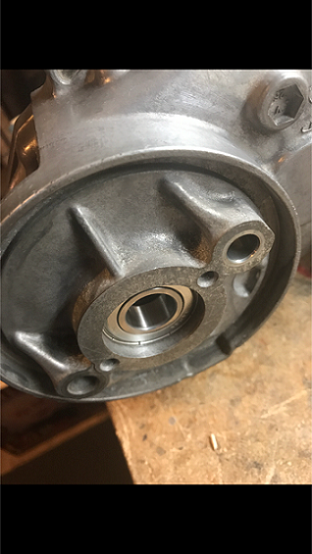

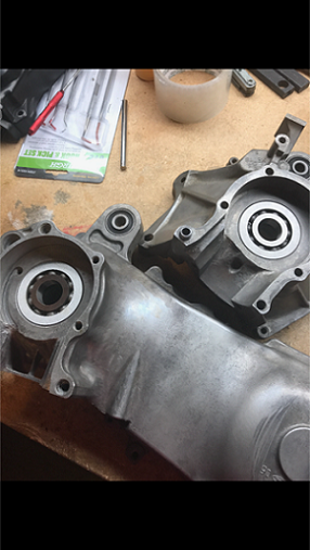

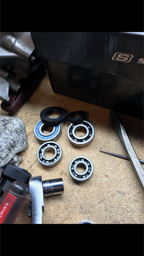

Now that grind work is done, case was cleaned of all shavings and prepped for assembly. Starting with trans bearing install. Freezing them overnight and heating up the case with a torch makes install a snap. They dont exactly fall in but just a few light taps to get them seated. Finding an OEM Honda 6202 bearing isnt easy. All others are readily available everywhere but that one. I gave up and went with a quality Taiwan replacement.
image1 (4).PNG (254.71 KiB) Viewed 16575 times

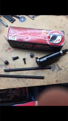

Pulling the crank is too easy with the TUSK tool. Almost like cheating. To seal up the case I used Yamabond. You'd be surprised how many Honda shops use this stuff over Hondabond.
image2 (3).PNG (252.66 KiB) Viewed 16575 times

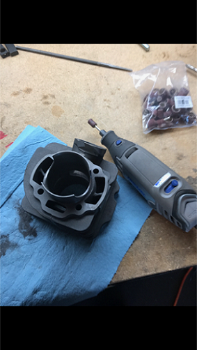

Now that the PG full-circle 50mm stroke crank is installed and the case is sealed up, I move onto the 50mm bore. I went with a PG for that as well. They make good quality products but some prep work should be done before install. Time to bust out the Dremel again!

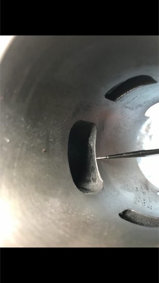

Taking a tiny jeweler's file I carefully chamferred the ports to remove the sharp edges. Its not much but enough to knock down the razor-like edges to let the rings happily slide by.

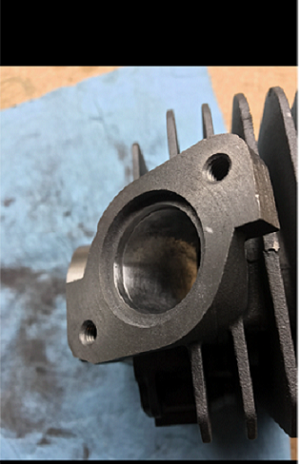

The exhaust port had rather large casting flaws so it needed to be sanded down smooth. Then I polished it to a mirror finish to allow better flow of exhaust gasses and to reduce carbon build-up.

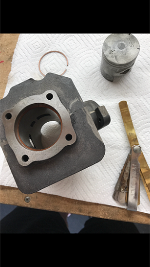

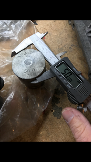

After all the grinding on the bore, it was fully cleaned of all shavings and oiled. Now I can check the ring end gap. Surprisingly, one ring was within spec but the other was too tight and needed a couple passes on a file.
image3 (2).PNG (252.65 KiB) Viewed 16575 times
image4 (2).PNG (219.58 KiB) Viewed 16575 times
