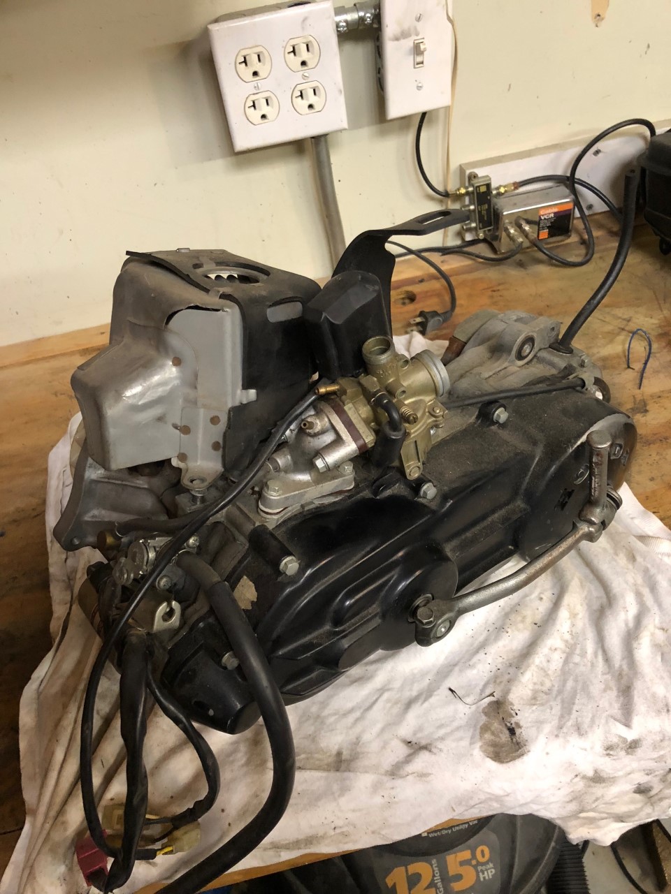

Here's mine. Easiest swap ever haha. 87 aero 50 motor
I just ripped the motor back down on this one, I'm going to do a ported airsal BBK with a jasil racing crank along with a 24 mm pwk carb and some kind of pipe, not sure which one though. Maybe A proma bad snake or Homoet.

where did you procure that jasil race crank? I thought those were long out of production.

I did not procure one. I wanted one, but they were too hard to find. Going back to a stock motor.
