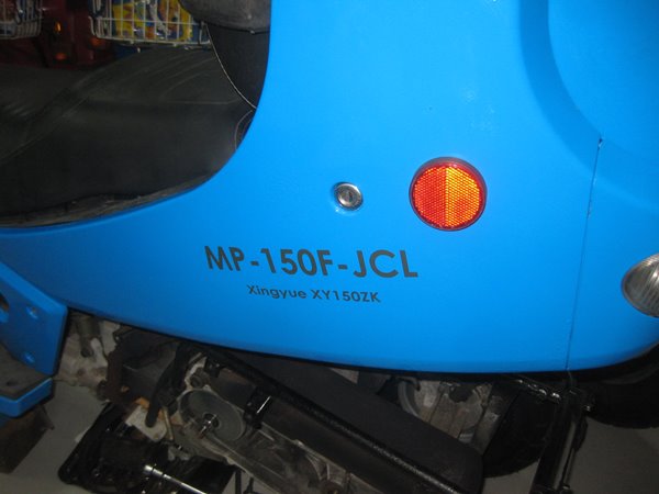

Technically this one is called a MP-150F-JCL according to the details on the body decal. Not sure how much interest there is for this one on this forum, but I can't find an AutoMoto forum that is still active..

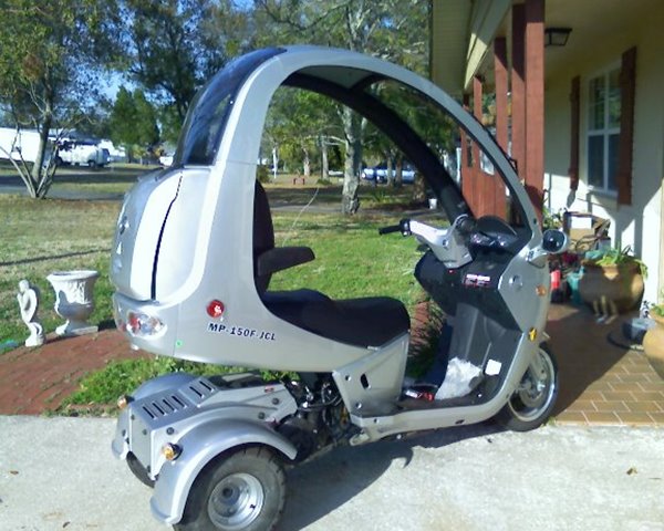

The previous owner sent me a photo of what this one was like when it was new:

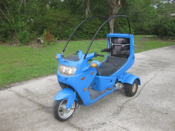

This is what it looks like as of today. This weekend, I hope to paint the front body, front fender, the engine cover, and if all goes well, all 7 of the plastic roof pieces that are colored. There are an additional 7 black pieces that form the interior of the roof, and all of them need repair and cleanup.

I finished repairing and painting all of the front body parts and the engine cover three days ago, and finished repairing and painting all the roof pieces yesterday, just ahead of the rain today in Florida. I'm going to watch the Monaco Grand Prix, The Indy 500 and the World 600 today on the shop TV while continuing to assemble the Xingyue. The darn thing has taken over the shop. It is huge and has more than 25 painted plastic parts, most of which needed repair for broken tabs or cracks.
It will take me the better part of this week to put it all back together. I found an original two person seat, a set of windshield wiper arms, and a clear used back window in Colorado, and UPS tracking says they will arrive late in the week. Same for the new rear tires, due to arrive via UPS from China on Friday. I have been reluctant to ride the scooter much because one of the tubeless rear tires had a bad sidewall split, and I repaired it by putting a wrong sized inner tube in it so I could roll the scooter around in the shop. I am not sure that the scooter would be controllable with a rear tire blowout at 45 mph.

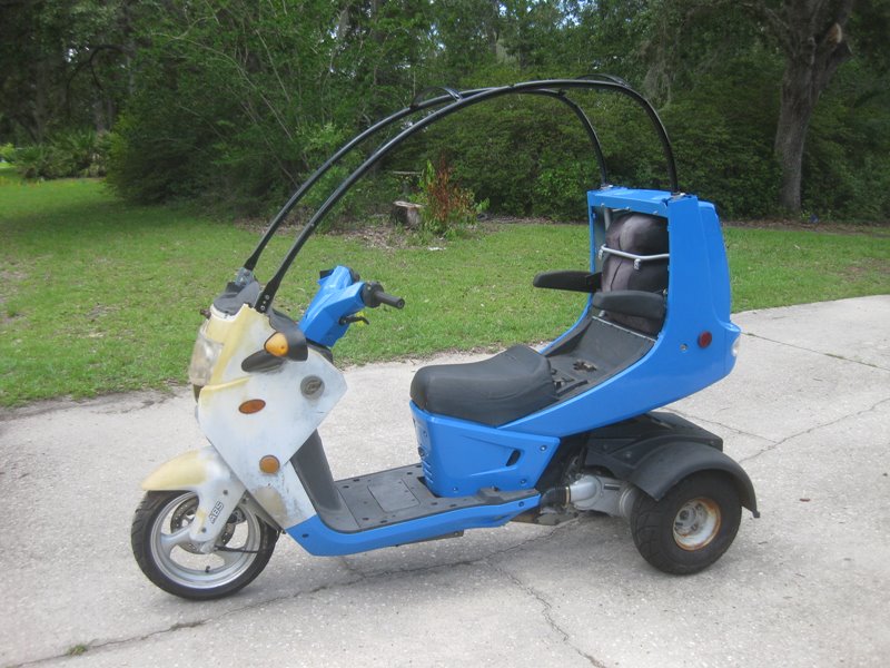

I spent another long day today working on the Xingyue. I have put in about ten eight hour days so far. My biggest reason for the slow pace is my failing short distance eyesight.
On my test ride today, the fuel tank sending unit packed it in, so I now have one on order. The points in the slider failed and came apart. One good thing about GY6 scooter parts, a new sending unit is about $10 on eBay.
I did have a bit of a breakthrough today. When I got the scooter, the previous owner had thrown away the carb and the CDI unit and replaced the CDI unit with one of those with the colored aluminum heat dissipating "racing" CDIs. The carb is one of the standard GY6 cheap ones on eBay and I looked at the mainjet and it is a 102, just like the one I ordered for my TGB 150 with the same problem. The TGB missed badly under heavy load at any speed, until I put in a 120 mainjet. The TGB now runs perfectly, and the acceleration is thrilling. The first week that I had the Xingyue, I replaced the "racing CDI" with what was supposed to be a factory stock black GY6 CDI. Sometimes when I tried to start the Xingyue it kicked back, like the timing was too advanced at slow speed. Yesterday, I ordered a CDI with adjustable timing, to see if I could improve the starting. I am lucky that I didn't break the starter as the kickback was quite violent. I also found this youtube video showing Patrick from Georgia riding his out to the lake:
https://www.youtube.com/watch?v=koH-NXk3AOY
The same man has many youtube videos and he regularly cruises with the speedometer needle straight up. Just like you said in a previous post, the speedometer on the Xingyue seems to be accurate, unlike most of the other Chinese scooters. In this next video, you can see that straight up is roughly 45 MPH, and he effortlessly is able to hold that speed up and down hills.
https://www.youtube.com/watch?v=n82bIqVU6YQ
With my Xingyue, the top speed on the level was about 36 mph, and the scooter would slow down to about 25 going up a slight hill. As I said, it felt sluggish and heavy and it would be embarrassingly in the way in traffic.
Just to see what would happen if I put the "racing" cdi back in place, I did that and went for a test ride with the Xingyue. The result was amazing. The scooter now throws you back into the seat when you accelerate, and 45 mph is effortless, uphill or on the level, and it is still briskly accelerating at 45. It would go faster than safe on the maypop rear tires. On the way home, I went by my insurance agent and bought a liability policy for it. The acceleration and top speed is now very similar to the TGB 150. Even though it has a 102 mainjet, the Xingyue doesn't have a miss under acceleration. I may change to a 120 mainjet just to see what happens.

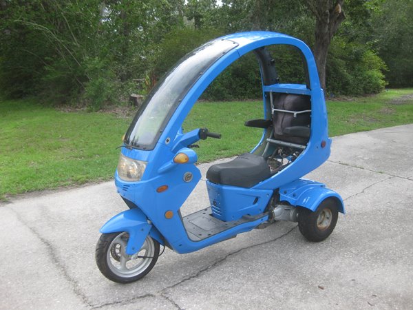

The bottom line is that now the Xingyue is scary fast instead of a slug.. It is now "something", rather than nothing. Here is the photo I took today after my test ride:

Other than replacing the four storage compartment screws with the original ones, and installing the front windshield vanity caps, and then cleaning up the top of the workbench, I'm going to take most of the day off, as I have a day or two before parts arrive. I'll also take a longer test ride today as well.

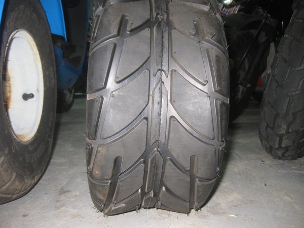

There are two more significant tasks left to do. The new tires arrived from QINGDA, straight from China, and they are perfect.. same company as the original tires, and same tread pattern, same sidewall markings but brand new. The size is 16x8.00-7. Tomorrow, I'll dismount the maypops, and paint the rear wheels, and then on Tuesday, I'll mount the new tires. Then I'll finally be able to make a few high speed runs to see what the top speed of the scooter turns out to be.
Here is one of the maypops:
Here is one of the new ones:

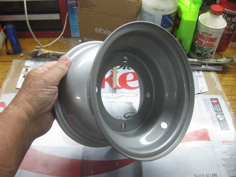

I painted the rear wheels with silver Nason urethane and then mounted the new tires. The wheels are just fabricated out of thin sheet metal and it is a bit worrisome to think I'll be driving the scooter at 50 mph on these puppies:

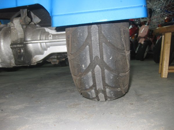

After installing the tires on the wheels by hand, and then installing them on the scooter, I took the scooter out for a test run and found that the rear end had a very bad bounce at 30 mph, making it almost undriveable. The bounce clears up above 32 mph, and the ride was pretty smooth riding at 45 mph. I took the tires and wheels to the local tire shop and spun them on their balancer to see what was going on. Both new tires were pretty similar to each other and both out of round. I was running 30 PSI in the rear tires per the workshop manual, even though the max pressure rating on the sidewalls is 25 PSI. I dropped the pressure down to 20 PSI, and still had some bounce, but the scooter was now at least driveable. I was running the old maypops at 30 PSI and they had no bounce.

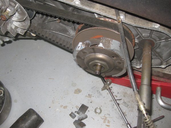

In any event, I discovered a more significant problem in my test runs. The clutch would start dragging after riding the scooter for 5 minutes or so. After a 10 minute ride, it would be tough to sit at a stoplight as the clutch would be dragging pretty hard. I decided to go for a 15 mile high speed test run, so I rode 7 miles down the highway at 45-50 mph, and then started back home. About a mile from home, the scooter suddenly picked up a new serious vibration, and when I got to the only stop sign on the route, I found that the clutch was completely locked up and the engine immediately stalled when I came to a stop. When I start the scooter in a difficult situation, I usually put the tilt lock on, and then push the foot brake that operates both rear brakes. That locks the rear brakes and is called the "emergency brake". It also operates the rear brake light switch and that permits the starter to be engaged. I do this instead of holding the front brake lever, as it gives me more freedom to operating the throttle without holding the brake lever on. Luckily, the battery was fully charged, and I was able to start the engine, and the scooter immediately moved forward even thought the tilt lock and emergency brake was still on. I managed to get the tilt lock off without crashing the scooter, but I forgot to push on the foot brake to release the emergency brakes, and so drove home with the rear brakes on. When I got home, the rear brakes were very hot and everything was pretty much locked up. I put the scooter away and went to bed pretty discouraged. So far I have put about 130 KM on the scooter since I got it running.
This morning, the rear brakes seem OK, but the clutch is still locked up. I'm going down to the sign shop first thing to pick up the signs they made for the scooter. I'm getting two "MP-150F-JCL" vinyl decals, one for each side, and two "ABS" decals that go on either side of the vertical parts of the front fender. These scooters came with various logos depending on the reseller. Mine is a JCL, not an Automoto or a Vogue. When I get home, I'll apply the signs, and then start the job of removing the side cover and see what is going on in there. I found this video that shows pretty well the steps to remove the side cover:

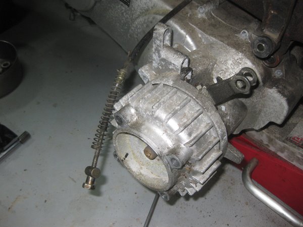

I'm feeling better this afternoon after inspecting the clutch. The job of removing the belt cover wasn't as bad as I expected, and the video was a big time saver. I don't think I broke anything new getting the cover off. The rear brakes are fine after cooling down overnight. Here is a photo of one of the cute little aluminum finned rear brake drums:
The belt cover came off pretty easily, and it was obvious what was wrong with the clutch:

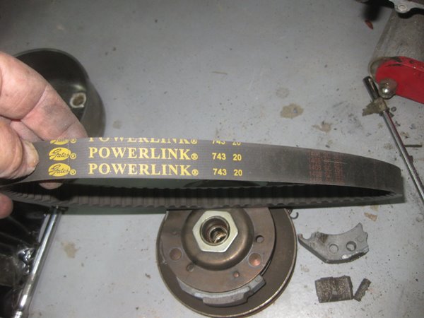

The belt looked like new, but is 10 years old, so I will replace it with a new Gates belt of the same size. I'll post this photo in case someone finds this posting a few years from now and wonders the size of the belt. This size of belt corresponds to a standard GY6 150 short case belt:
One thing about GY6 parts.. they are pretty cheap and readily available. I ordered a new clutch and belt on eBay and the total for the pair with shipping was about $40. I also picked up the decals at the sign shop and installed them:

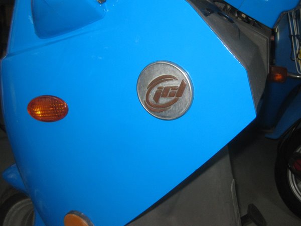

As I wrote earlier, the Xingyue XY150ZK was sold by many resellers. There are three round logo badges on the car, and I guess Zingyue made special round badges for each reseller. I have seen pictures on the internet of the Automoto and Vogue round badges, but here is what the JCL badges look like:

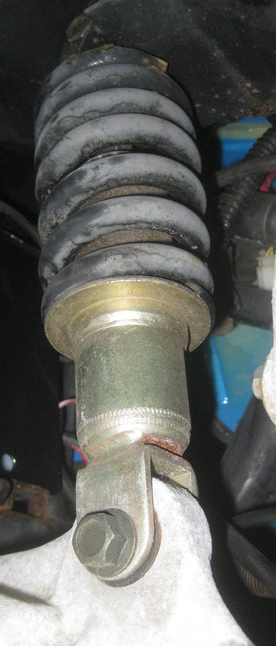

Now I am searching for a new rear shock. I started emailing vendors asking if they could help. The shock has an eye at one end and a clevis at the other end, and uses M10 bolts at each end. The distance between mounting holes is 235mm and the spring is very heavy duty with 6 1/2 coils. If anyone has any ideas for sourcing a shock, please let me know.
Here is a photo of the clevis end of the shock, looking up. The eye end is out of sight at the top.
