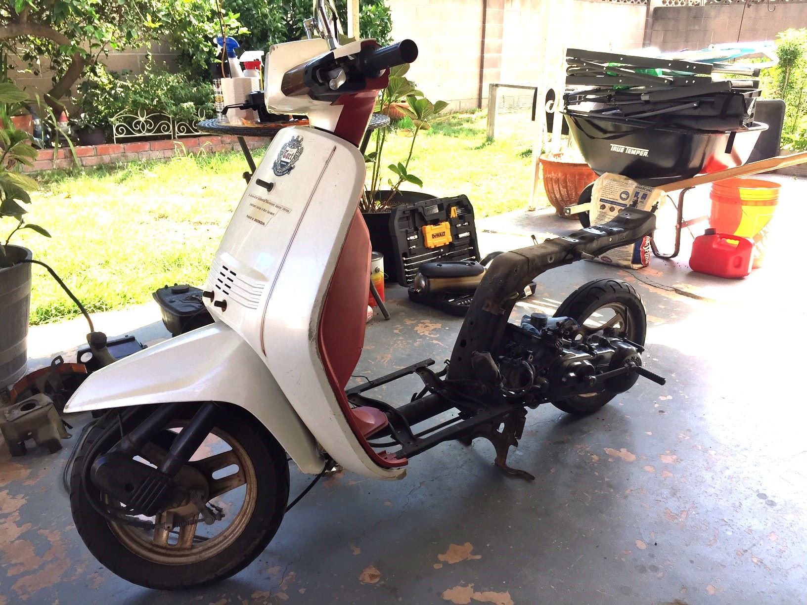

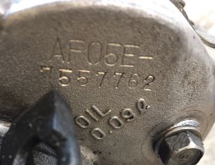

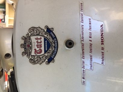

I recently acquired, and killed (more later), a JDM AF05e tucked under a 1985 TACT TRAD. I'm located in So. California, and I joined this thread to add what I've found so far. Also hoping to gain/contribute restoration insights and learn sources for the JDM-specific parts. The scooter ID info is below. I have MANY pics of the Malossi BBK next to the JDM cylinder (seeking advice) plus a few engine pics so far. I'll get more pics up in next post.
Decals are a bit worn !!
Plastic Front.jpg (21.38 KiB) Viewed 36297 times
Stamped into the Gear Box
As Found Under the Seat

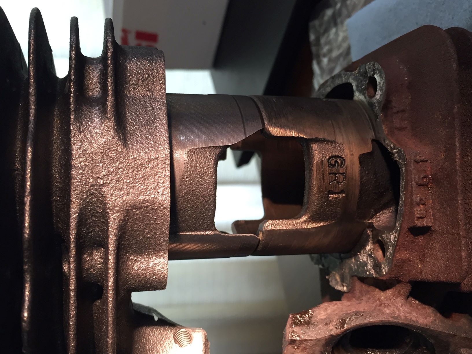

I want to focus on the Malossi BBK now. For the record, its Cylinder Kit PN 31 6405.
The BIG question is...will this be compatible with the JDM AF05e cylinder?
Here is the boost port:
Malossi BBK on the right
Skirt View 3.jpg (263.84 KiB) Viewed 36286 times
Malossi BBK
Malossi BBK
Port 3b-1.jpg (233.6 KiB) Viewed 36286 times
JDM AF05e cylinder
JDM AF05e cylinder
Port 3a-1.jpg (449.15 KiB) Viewed 36286 times

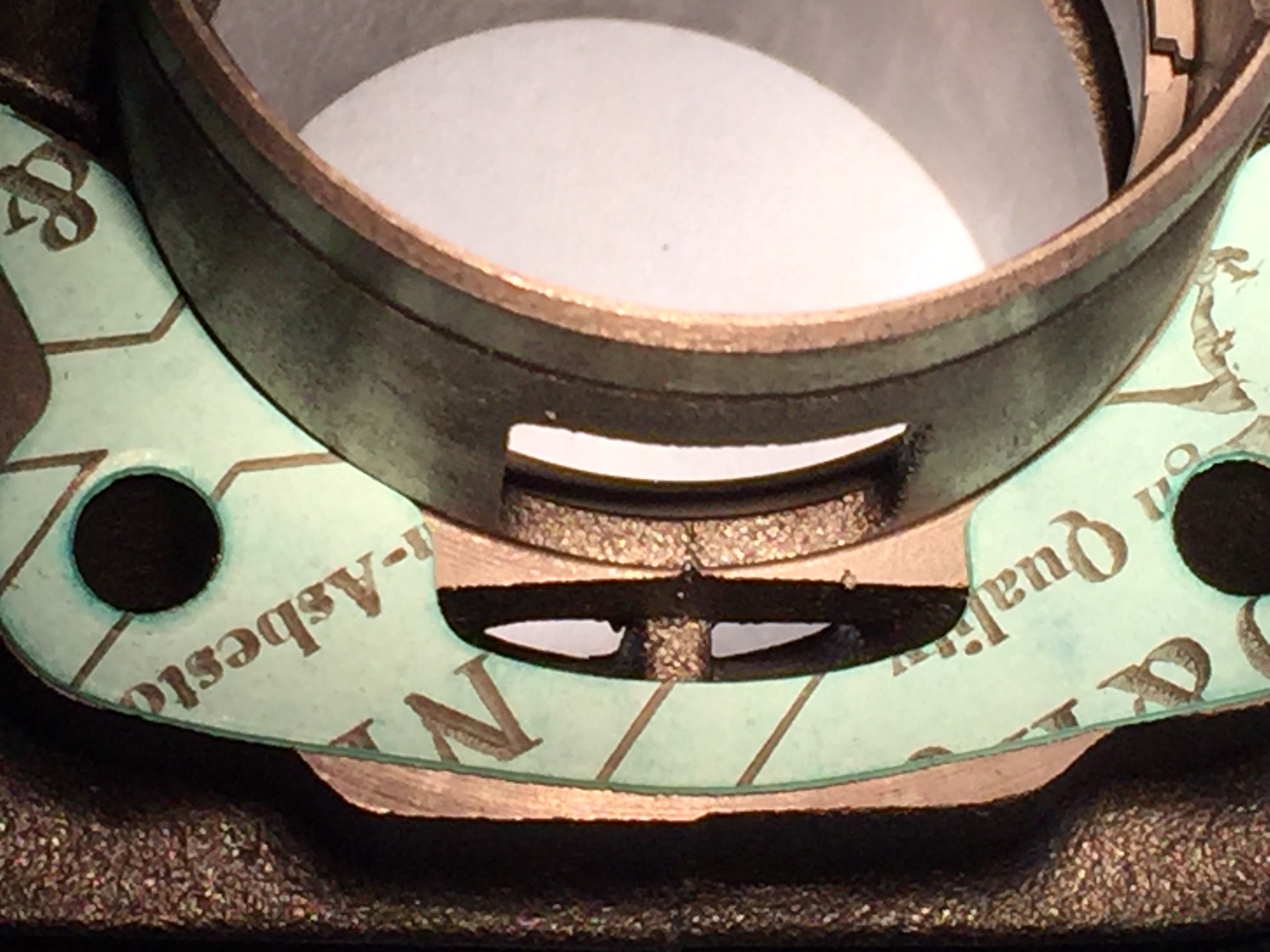

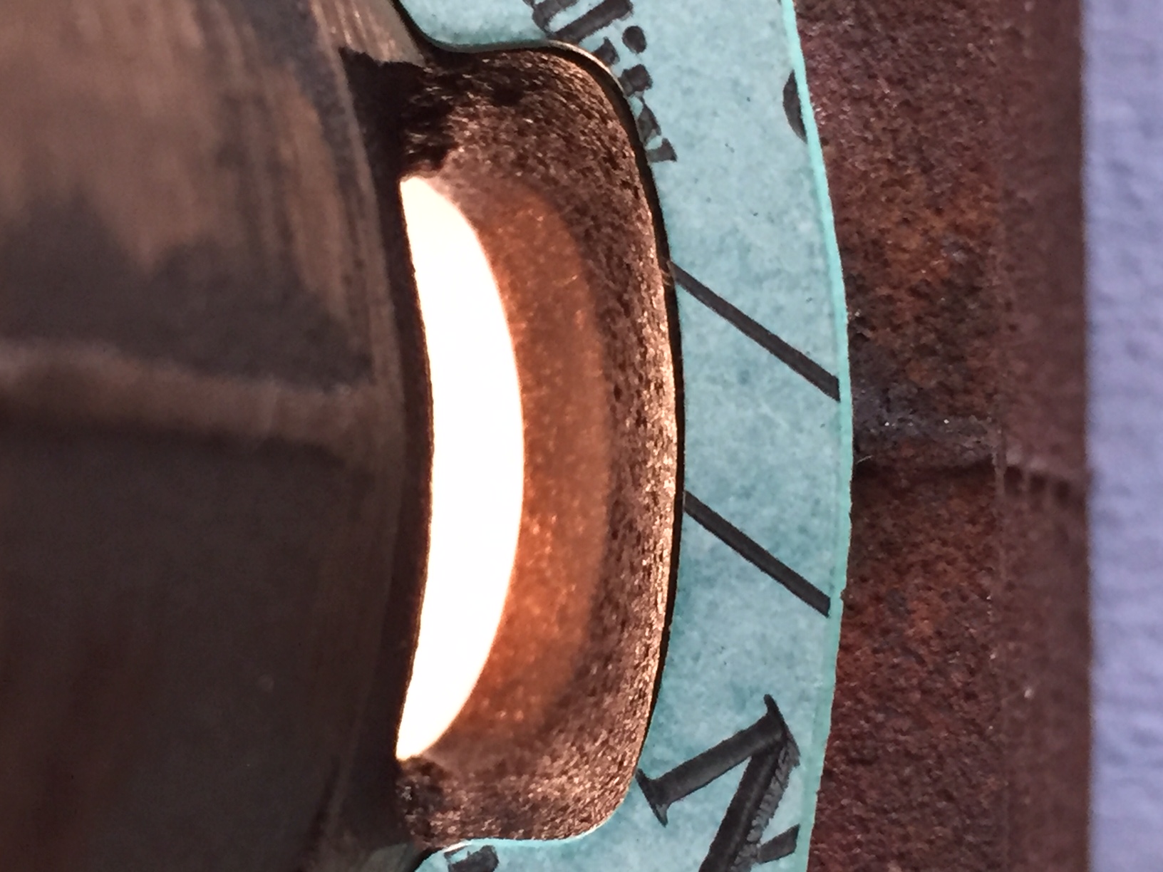

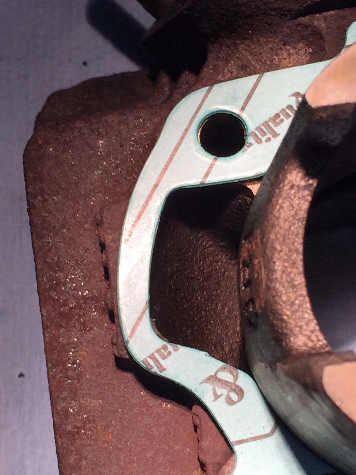

Gasket fitment at Boost Port. Malossi BBK vs JDM AF05e
NE50 Gasket on Malossi BBK
Gasket 1c.JPG (460.62 KiB) Viewed 36285 times
NE50 Gasket on JDM AF05e
Gasket 2c.JPG (417.68 KiB) Viewed 36285 times

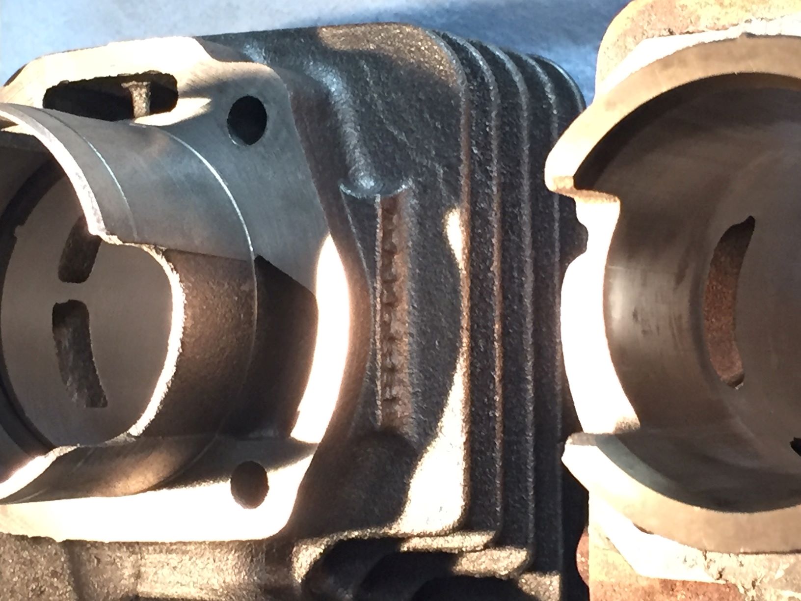

Malossi BBK vs JDM AF05e cylinder at intake ports...
Port Differences 2.jpg (209.24 KiB) Viewed 36284 times
Port Alignment 2.jpg (288 KiB) Viewed 36284 times
Port Alignment 1.jpg (259.23 KiB) Viewed 36284 times

OK, if you read through these several posts (yup, I suck at attachments!) you figured out I'm asking the forum if this Malossi BBK is appropriate for installation into this 1985 JDM AF05e (Model NE50M TACT)?

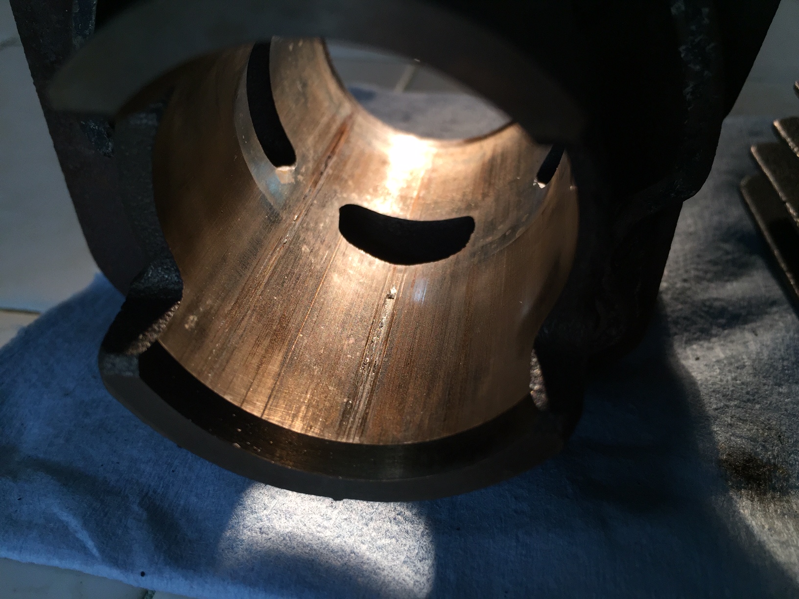

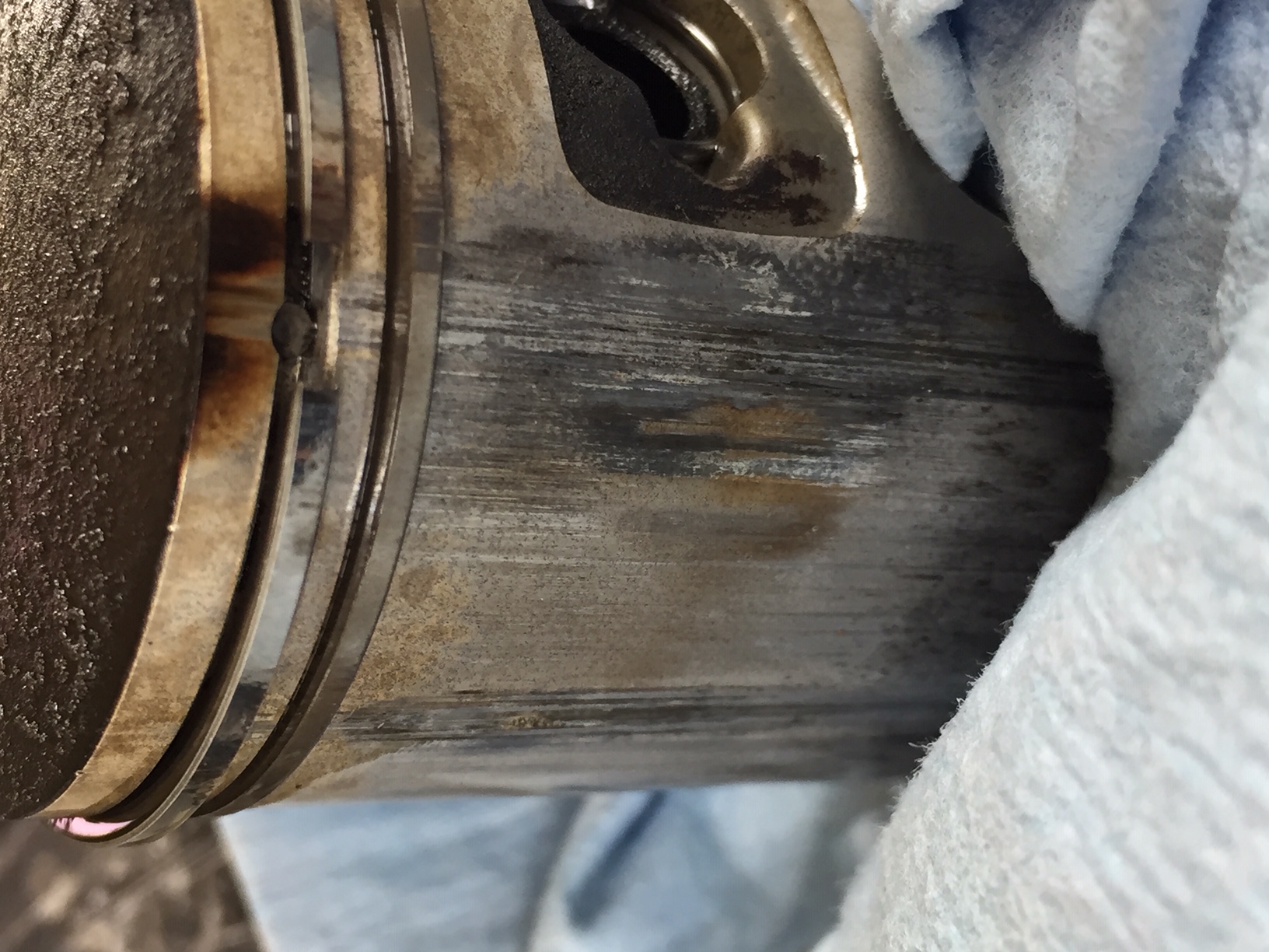

Sooo, my first scooter; trusted the oil injector; put an NCY exhaust on it and eagerly embarked on my first attempt at 2-stroke carb tuning. This is what happens when you run too lean for too long with questionable oil ratio:
Cylinder 2.JPG (584.2 KiB) Viewed 36280 times
harleyracer59
Posts: 258
Location: Nickastan ca
Re: jdm and US spec AF05E differences
Post by harleyracer59 »
What’s up man. I still check in here from time to time.
I’m really surprised that the malossi is that sloppy on the boost port. To answer your question, yes thst cylinder will fit and work on your jdm afo5e. I would put the gasket
On the cases and make any material you see inside of gasket and do the same for the cylinder. Then I would use a dremel and remove all of the material and smooth out the paths to the port opening. Thst malossi really needs to be cleaned up on thst boost port. That’s just terrible. The quality and finish from malossi used to be better.
