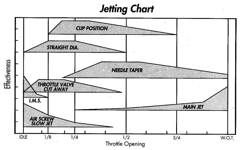

by bonesv
Main jet is only in operation when the slide needle is raised (throttle) and fuel is drawn into the carburetor's venturi (https://www.merriam-webster.com/dictionary/venturi) thus when the throttle is at closed to about 1/8th open, the pilot jet is pretty much the only fuel drawn into the carburetor. So the air/fuel mixture screw is only effective to adjust the pilot jet circuit, but as the throttle is opened further the pilot jet is still working thru the whole range and could have some affect on overall jetting. I just don't think it's very much.
The lighter rollers have nothing to do with the jetting.

Thank you, I am still learning about the intricacies of carburetor operations. I think what the other post was getting at was that because with lighter weights the engine would rev higher, a bigger jet might be necessary to supply the necessary fuel/oil at the higher rev.
So, as I understand it, the mix screw only affects the pilot jet, so at WOT it would just end up running rich regardless with an 88.
