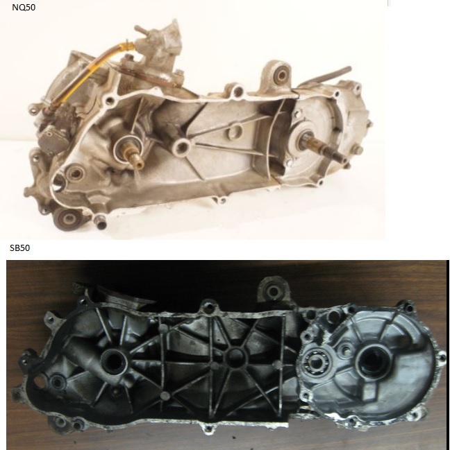

noiseguy wrote:... so the motor case broke between the rear axle and crankshaft? I've never seen that failure.
Me either, but recall Honda increased ribs in the SB50 case.
Edit: Update - upon member ntonar's feedback, the 86-87 cases were observed to have increased ribbing. The parts fiche diagram for 86-87 incorrectly shows same ribs as 1984-85 Spree. However, the case p/n show the same P/N is used on 86-87 Spree as the 88 SB50.

...the SB50 is also a lot heavier than the Spree.

[quote="noiseguy"]...the SB50 is also a lot heavier than the Spree.[/quote]
For the curious - The delta at time of change was 14lbs. From the respective Service Manuals, the SB50 was 108 lbs (dry) and the '87 Spree it replaced was 94 lbs.
The original 84-85 Sprees were the lightest at 86 lbs dry, the '86 was 92 lbs.

Thanks for posting, and glad you are ok. I posted the SB50 case info to pass 'tribal knowlege' around. Since you are looking around for an engine, the SB50 gives one more option.I do not have an opinion that Honda had a breakage issue with the Spree case. I just note they beefed up the case.
