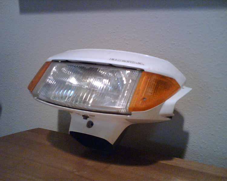

if you want to run the dj1 headlight, you need the jdm handle bars. the mounting points are a bit off just like the tail light. you need the rear inner fender plastic for the tail light to mount correctly.
one of these days ill start my 87 elite/dj1 build. I have an 87 se50 frame, dj1 fairings, lights, speedo, glovebox, and a jdm af05e, af35 forks and wheels. some day....

Yes, hence the word "headset" not headlight. IE whole assembly or "set" And correct tail light will need JDM rear trim/panel. You should start getting those parts soon they are getting harder to find even in japan. These bikes are kinda considered trash now days. 4T is the new thing
