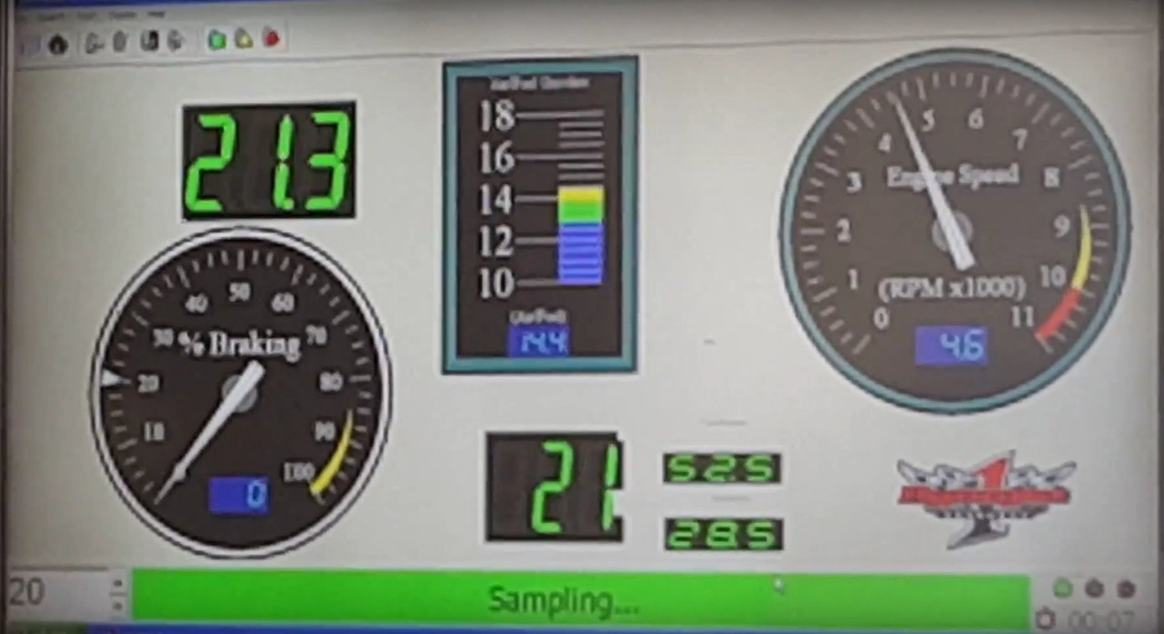

right, so clarification is in order. I have a 102cc AF16 that Tru72 built for me quite a few years ago. I am finally getting to a point in my life where I have some free time to tinker and I need to get some of my projects moving.
I am using a trailtech Vapor for a dash and it is giving me the readout for Rpm and speed. As it stands right now, I am getting the bike to move at about 4500rpm. I think that the springs are some ebay junk and I remember that they were a MF to get put on.
I think that I am going to start with getting some Polini springs and starting there. I sortof like the high launch, but when I come out of corners, the bike will lift the wheel sometimes and that is getting sketchy as of late.
