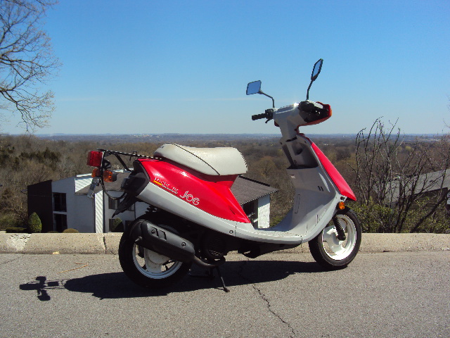

I have a 1993 Jog with 700 miles that I just returned to service.
Hope you continue to cherish the scooter for many years.
You can modify the old, tired scooters to make them better, faster, etc....BUT it will ONLY be this FRESH,...once.

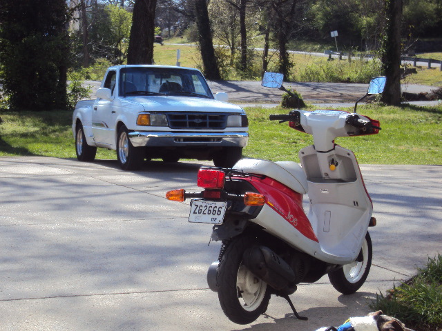

The Jog is mine hondapowersr...easy to make that mistake since you are new to this forum.
