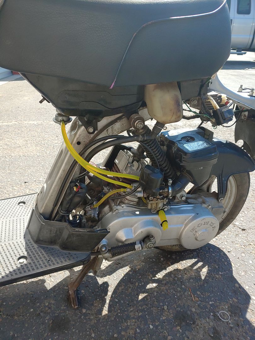

Cleaned the carb
Ported the intake manifold
New fuel lines
New Honda oiled air filter
Modified a 46cc dominate pipe to fit
Runs SO much better after the carb cleaning the low end acceleration is much better. Still tops out around 35mph but it picks up alot better. My only concern is after reading multiple tuning guides , I cant seem to get the idle down. It starts and runs good but its noticeably higher rpm at idle now. I did the 1 1/2 turns out on the bottom mix screw and then revved it for highest rpm but the idle would stay high even with turning the idle screw almost all the way out. I used honda bond to seal everything up and rechecked the bolts for the manifold, reeds, carb and everything is still tight.
New fuel lines

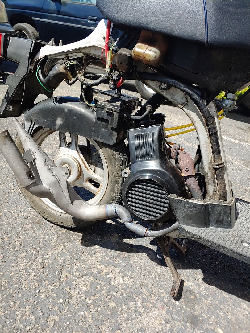

Just a quick throw together. Cut the stock front section so I can put it back to original, which I might do. Its loud.
