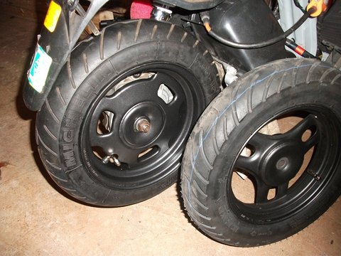

Metro rear tire from a user on here. brand new 90/90 on it for the white scoot to get a little more top end.
Some said the 90/90 doesnt fit but it will on the 86+. I think on the 85s it probably hits the kick, but dunno. It was tough to get it past the exhaust mount but it goes on and helps top speed a little. Definitely helps on the bumps.

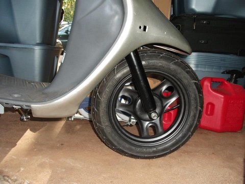

80/90-10 tire is no problem on a metro front wheel. I used to run those unit I found 90/65-10 I needed my drifter friend to use a cheeta/bead blaster on that tire... your aero looks awsome. I always wanted one.

80/90-10 IRC on honda metro front wheel. The ruckus rear wheel would look nice with a 90/90 tore too.
