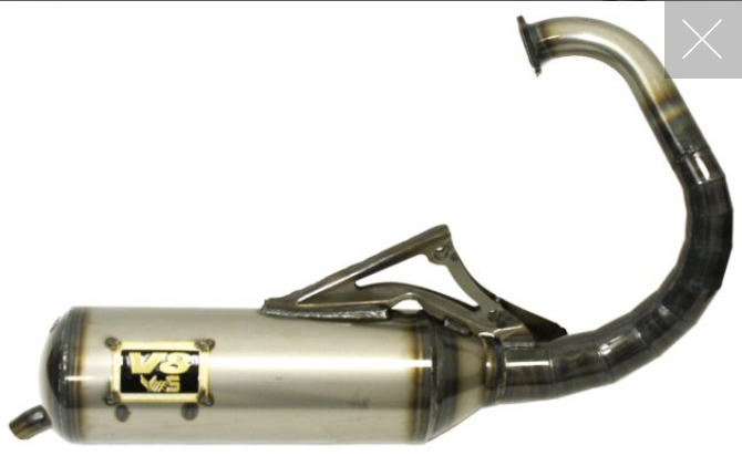

While on the topic of sport pipes...anyone know if theres any actual difference between these three BESIDES brand? Internals, tube diameter, material thickness, performance, etc...or is this just a generic mass produced pipe that anyone can slap a label on and sell as their own?
harleyracer59
Posts: 258
Location: Nickastan ca
Re: NCY Exhaust Jetting AF16
Post by harleyracer59 »
on the scooter works site it says the ncy pipe that they recommended nate should get was designed for a 50mm bore. that's most of the reason I thought that pipe was too big and not suited for his stock 39mm cylinder. id be interested to see the insides of these. by the outside shape. I don't see how they can be considered a performance pipe. theres no visual chamber or silencer. makes me think they look like stock mufflers inside. which would be terrible for performance

Meatball wrote: Thu Sep 19, 2019 5:44 pm While on the topic of sport pipes...anyone know if theres any actual difference between these three BESIDES brand? Internals, tube diameter, material thickness, performance, etc...or is this just a generic mass produced pipe that anyone can slap a label on and sell as their own?
Ive wondered this myself, Ive seen like 6 different pipes that look identical
