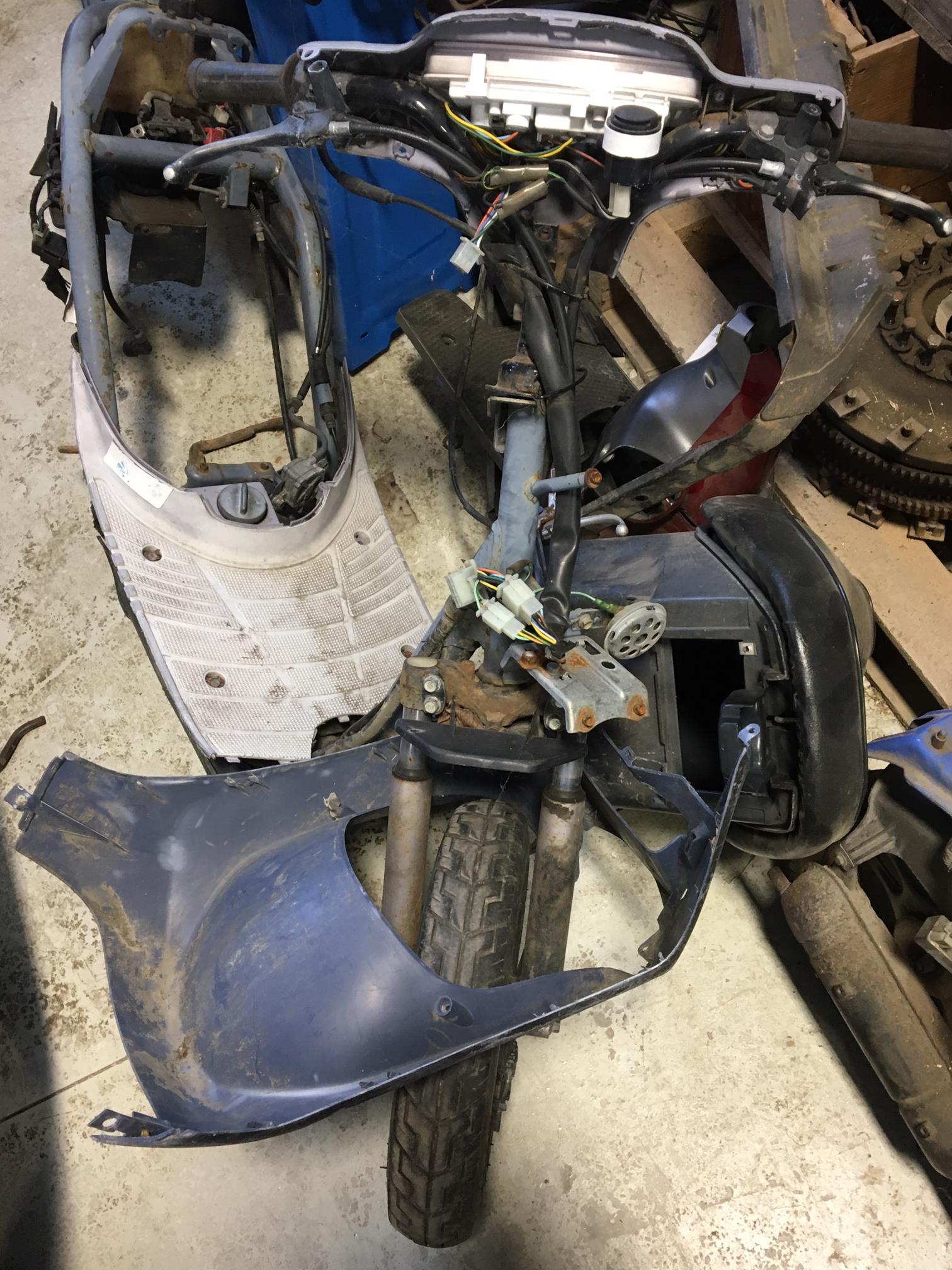

I believe my scooter is a genuine DJ1RR. It did have the fast AF05E engine in it. I bought it minus the engine as I've always intended to put in the AF18. See the pics. I've got a drum brake AF27 dio to trial run the headset and stem on the DJ1RR before I track down a proper AF28 or AF35 disk stem.

- DJ1RR (5).JPG (404.58 KiB) Viewed 30317 times
- DJ1RR (3).JPG (56.42 KiB) Viewed 30317 times

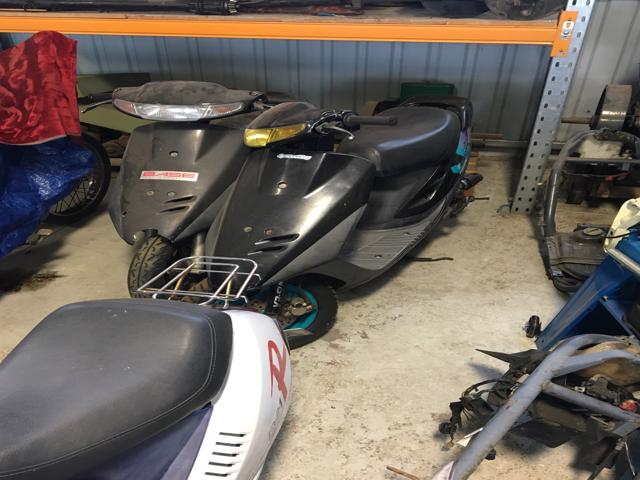

and some other scoots waiting patiently. The drum brake Dio is a * and is only a parts bike. My other ZX there has some wiring damage but has a 70cc cylinder (not sure what brand)
- DJ1RR (4).JPG (51.79 KiB) Viewed 30316 times

I think yours is a dj1r (af12) not a dj1rr (af19) your scooter has single head light bulb, no rear fairing scoops, af05e engine (originally), and I don't see dj1rr on your scooterexcept for thbe forks. dj1 and dj1r have a trailing link under shock like the 85-86 aeros.

you have a zx front end sitting right there. pull it offthe black zx and try it on your dj1r. then report back your findings. if the top corners of the fork legs hit your plastics, try a fork stem from a honda af55. aka metropolitan

no. in the 11 post in this thread, hes has a dio sr and a zx with a disc brake sitting there. he says the dio af18 is a parts scooter and the zx has wiring issues. I already have a dj1 head set for my 87 se/dj1 swapbonesv wrote: Mon Dec 30, 2019 6:59 pm He means the dj1 handlebars and headlight set. I didn’t see any af18 headsets on scooters in pics.
I was thinking, while youre pulling the head set off for me, pull the harness out of it and use it in your zx. should be swappable and that solves your wiring problem!
