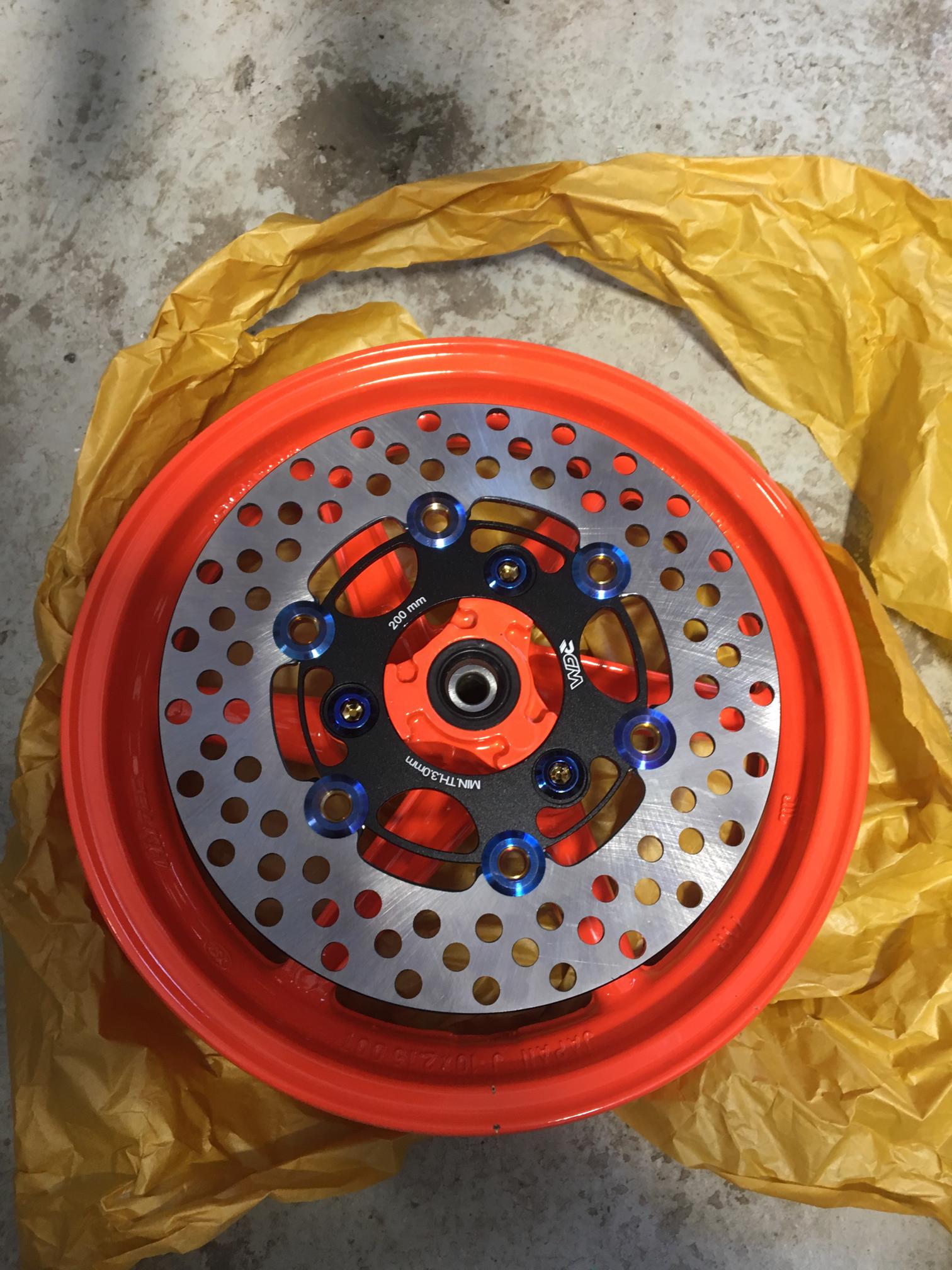

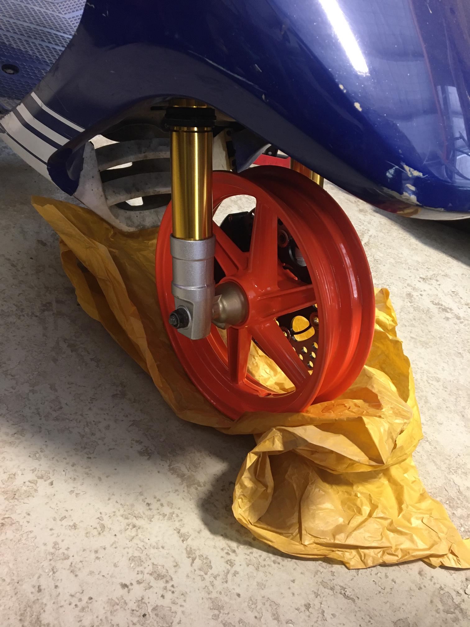

Todays mission was to strip the front end and put the AF35 DIO ZX stem in. It was very straight forward. This forum was very helpful in preparing me for the job. Recently I bought a totally stuffed AF35 here in NZ so stripped it out for the steering stem and handle bars. The rest can go in the bin. I'm not even using the shocks and wheel etc. I have installed the aftermarket shocks (shiny!), Trial fitted the alloy wheels with the 200mm disk. There is still some fettling to do with bolt lengths, nice washers and shimming the axle spacing to spread the forks out more so that the disk bolts don't foul the shocks. Then its onto figuring out how to match all of the wiring because I'm going to use the AF35 Dio ZX headset with the yellow headlight.
The headset will get tidied up and painted white.
I want a clean JDM look. I like the look of the AF35 headset on the DJ1R. Having a disk brake is a must for the stroker engine.
Anyway, enjoy the pics. I hope you like the colour scheme. Factory blue/white with bright orange wheels.
DJ1R 125cc Disk (1).JPG (360.88 KiB) Viewed 17201 times

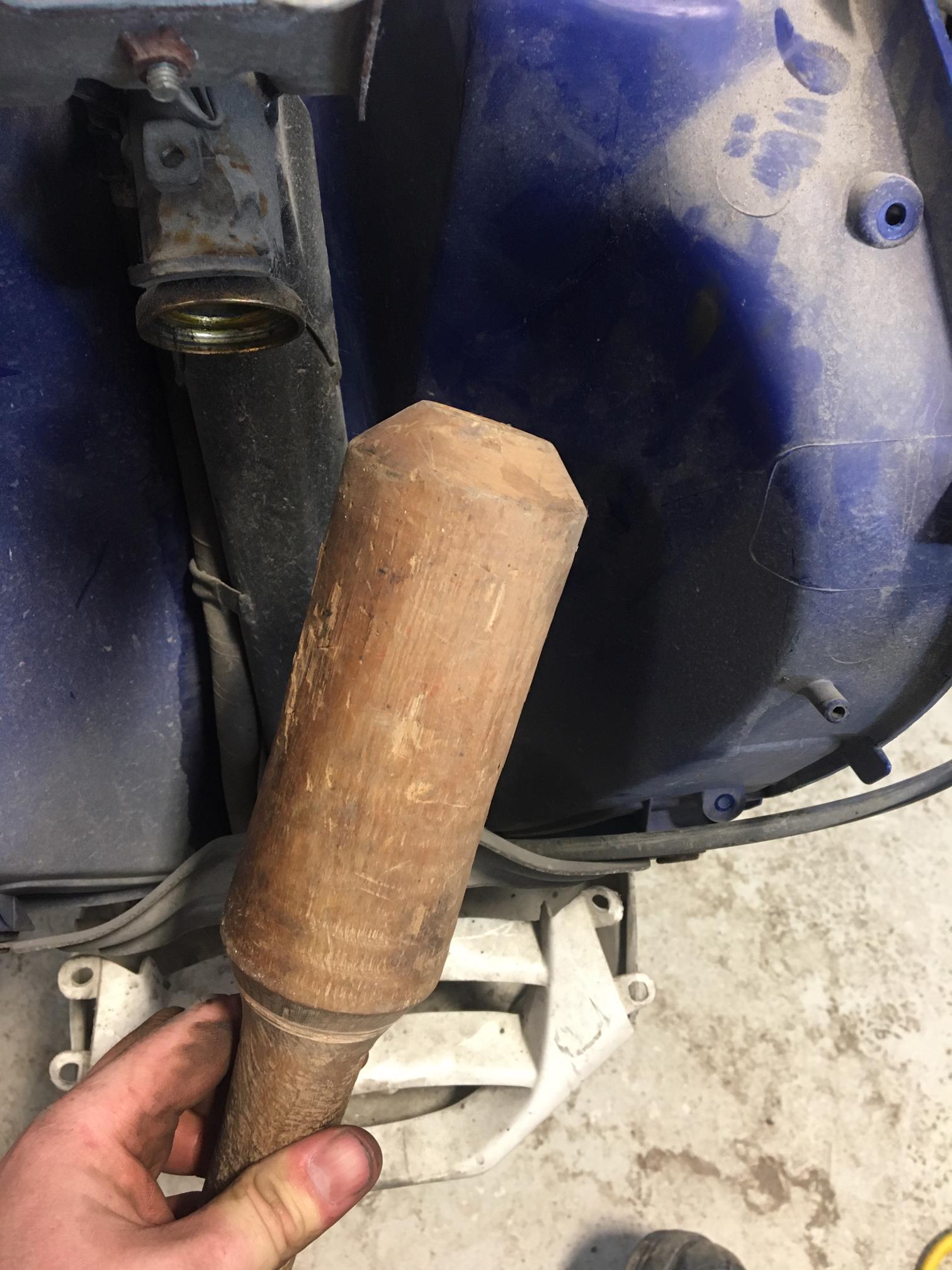

The steering stem bolted right in. I used the DJ1R bottom bearing cone. AF35 top nut. Greased both bearings and tightened it all up.
The stem is to wide for the factory plastics. I used a heat gun and a suitable wooden mallet thing I found in the shed to re-shape the panel. There is enough room but when I put the aftermarket shocks in the stick out above the steering stem. My cunning plan is to put it all together, use the heat gun on the outside of the panel and move the stem side to side to make enough room for itself. Should work out good.
DJ1R 125cc Disk (3).JPG (292.58 KiB) Viewed 17199 times
