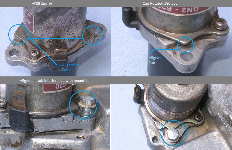

Yes. The Spree/85-87 Aero and 88-93 Elite SA50 starters use the same brushes, brush holder, springs and bearing.
The spin direction is set by the magnet orientation in the starter case. Thus if you pair a Spree/Aero/early Elite armature with a Gyro case, it will spin the correct direction.
-- To reverse starter direction w/o rewiring the brush holder --
If no Gyro can is available, you can grind off the alignment tabs on the starter case. Then rotate the case 180 degrees on assembly.
In the photo below, the can is rotated to show why is is necessary to grind the alignment tab.

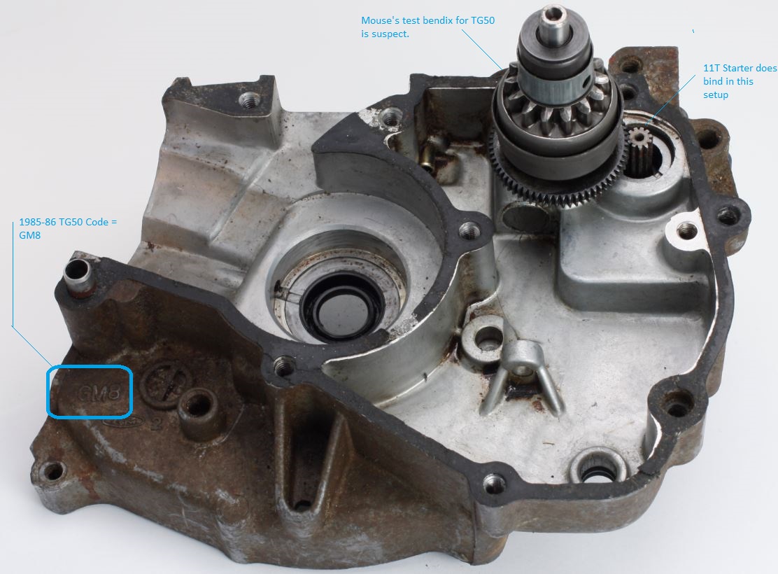

There's one part of 'identical' digging into. What is the tooth count on your Gyro starter? The OEM starter's I have for NN50 and TG50 Gyro's are 10 teeth.

however youre half right on the starters. one is 10 tooth the other is 11. you cant swap starters between nn and tg. I believe the 84 nn50 is the oddball 10 tooth and the 85-86 tg50 is the common 11 tooth. I could have it swapped around though. I cant remember

harleyracer59 wrote:however youre half right on the starters. one is 10 tooth the other is 11. you cant swap starters between nn and tg. I believe the 84 nn50 is the oddball 10 tooth and the 85-86 tg50 is the common 11 tooth. I could have it swapped around though. I cant remember
Thanks for the 11T clarification :thumbwink: I see on eBay sellers are careful now to mention 11T for TG50. Thus I need to update what I've posted elsewhere.
Years ago I did mock up a TG50 case side, Bendix and 11T starter. I still have the Bendix in a bag and repeated the mock up last night. It still binds. I'd conclude the Bendix I used for fit testing is not the correct part.

that's probably a tg starter and a nn Bendix. when I tried the 10tooth nn50 starter on a tg Bendix it made a god awful screeching noise
