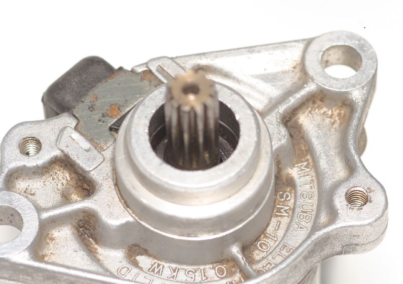

The starters we are interested in were built by Mitsuba with the series name SM-10. That family of starters has parts interchange within, as well as expected difference which made them unique to each Honda Model.
-- SM-10 starter Visual Guide and basic info --
The picture below shows the range of starters I looked at for parts interchange. Only the top row are viable candidates for parts. The lower row with Elite SB50 and 94-2001 Elite SA50 use a different armature brushes and brush holder.
Edit: 04/25/2020 - updated pic. Change: TG50 starter was 10 teeth, now shows 11 teeth. Input from harleyracer59 - thanks, much appreciated!

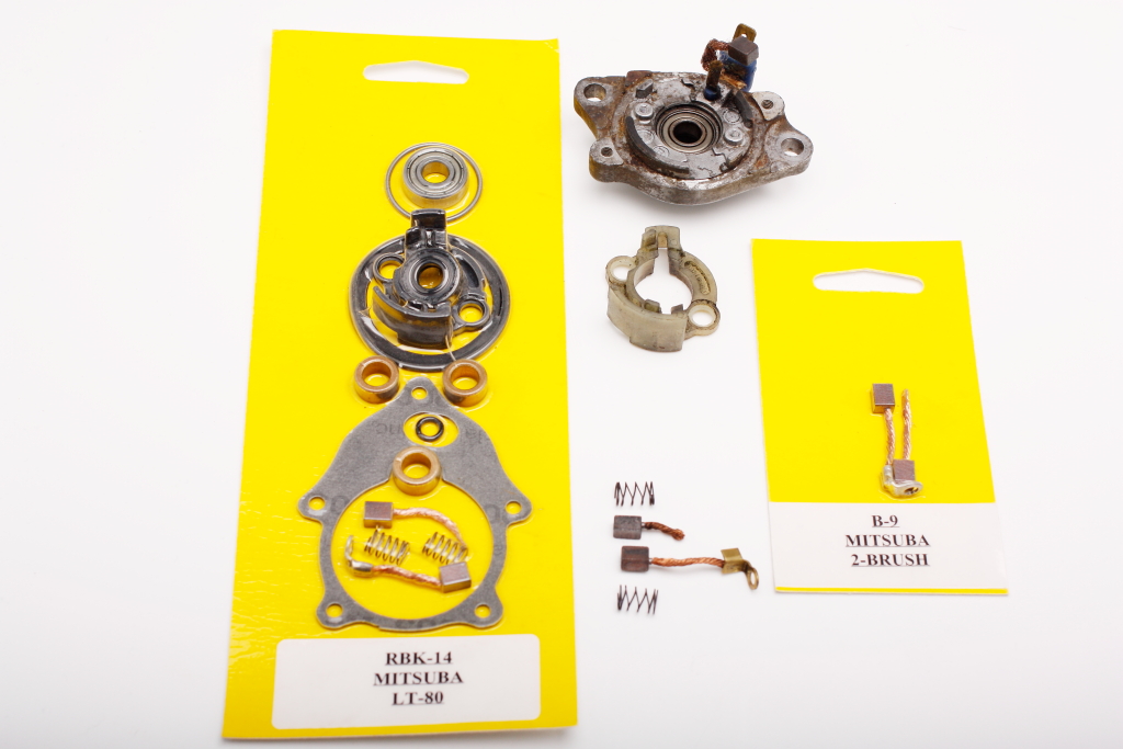

Issue: Bad brushes/springs/front bearing
1) Use parts from Suzuki LT-80 starter rebuild or brush kit. This starter uses identical brushes/springs and brush housing. Also same ball bearing and oil seal for the starter shaft

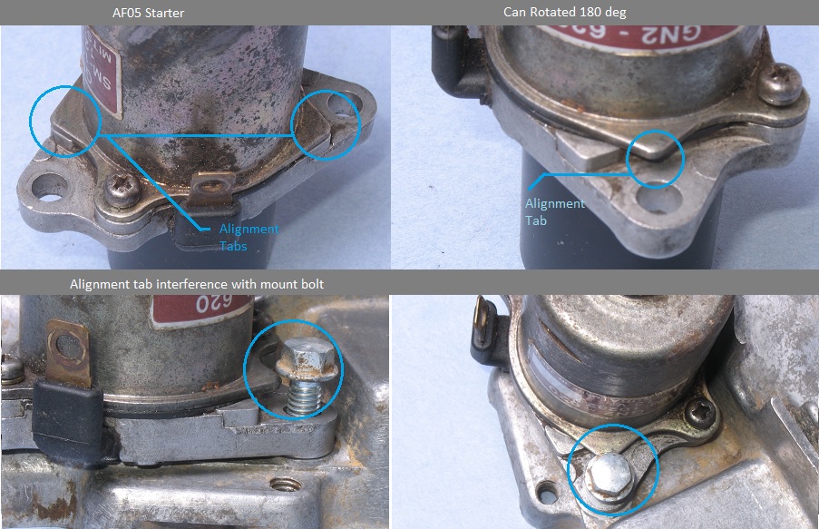

-- Reversing starter rotation --
As previously posted, the 1985-87 Aero/88-93 Elite SA50 starter have a counter clockwise rotation. This is reversed from the clockwise rotation of a Gyro starter.
You can rewire the starter internally to swap the +12v and ground leads. However it's easier to rotate the starter can by 180 degrees.
Take off the can, a few seconds on the grinder and put it back together.
The pic below shows the alignment tab which needs to be ground:

Starter Rebuild parts
These are the parts contained in the LT-80 starter rebuild kit I have. Some rebuild kits may omit the brush holder or other parts.
In between the kits are OEM Gyro starter mount plate, brush holder, brushes and springs.
Brush comparison Gyro vs LT-80 Brush kit

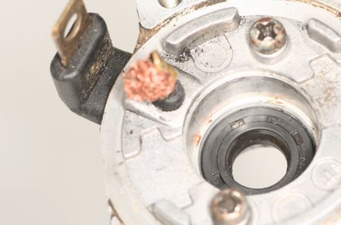

Where does the seal go? I can't seem to find any pics of how these come apart/go together.
Maybe I need to worry about my rusted up pinion gear before I start messing with starters... it was loose in the case by the starter. Not sure why, bad bushing maybe.
Re: Honda Gyro Starters
Posted: Sat Jun 06, 2020 9:06 am
The mounting plate of the Gyro starter is machined to seat both the bearing and the oil seal. You can see the distinct steps in the plate for each component.
The oil seal is installed such that the garter spring side is towards the crankcase.

3) Probably best to add the oil seal to output shaft. Only NN50 and TG50 starters had shaft oil seals.
gyro starters.jpg (48.96 KiB) Viewed 2476585 times
Ok, so based on that snipped of your pics above and what said, you CAN add the seal, right? Unless cheap aftermarket motors don't have the space.
The seal fits the SA50 starter in the photo. What I do not know is that for all years SA50 starters were machined to fit a seal.
On the aftermarket side, I have bought them a few times (but its now many years in the past), and none of them were machined to fit a seal
SA-50 starter with seal added
Aftermarket SA-50 starter without machining for oil seal

Interesting. The cheap SA50 starter I bought appears to have the area for the seal. There is a space between the bearing and further out lip..
