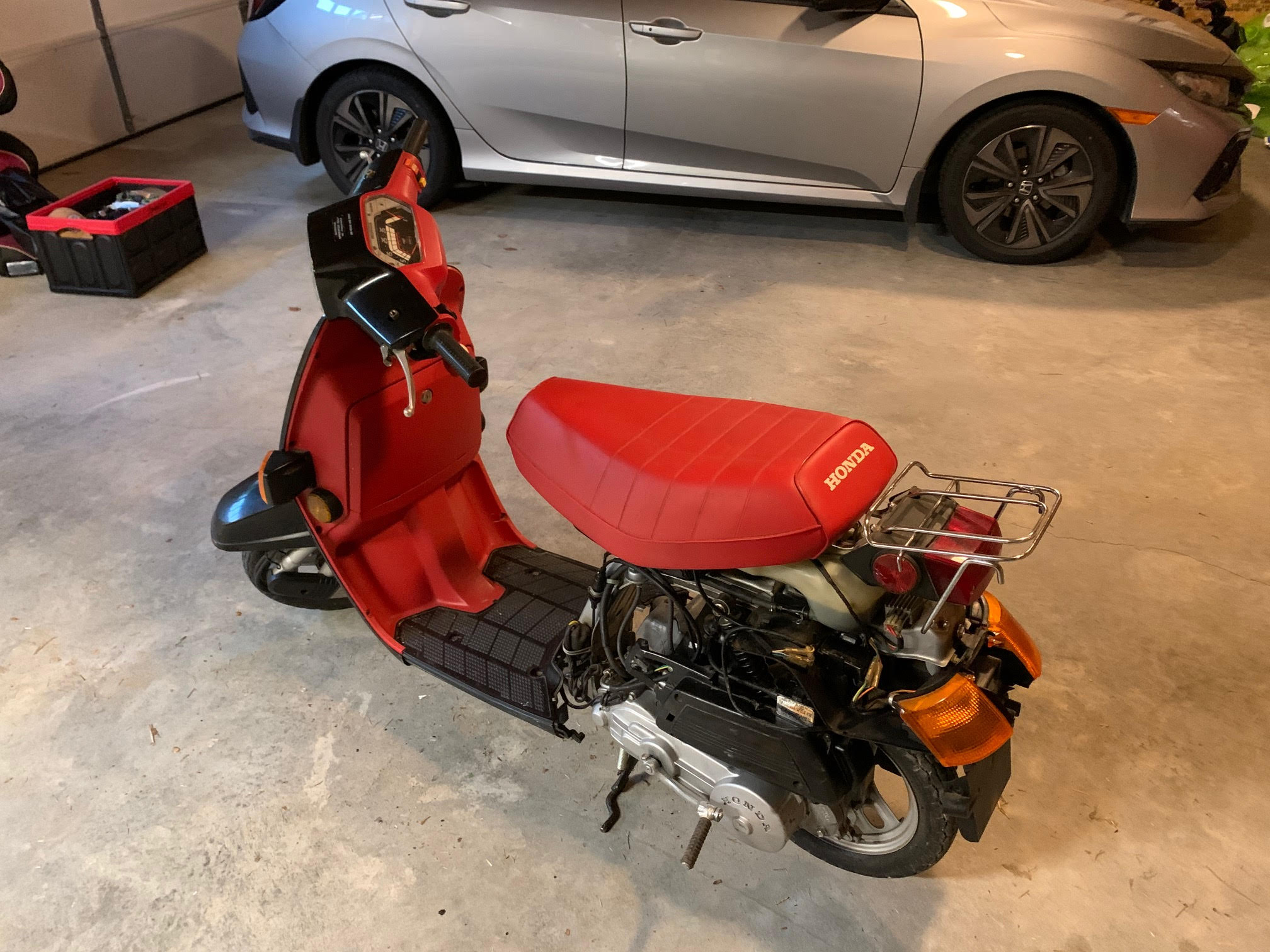

When I was a kid, long ago, all of the cool kids were rolling around on 4-wheelers (before they were called quads) and 3-wheelers (now affectionately death on wheels). Thinking myself cooler than all of these kids, I asked for a 50cc Honda scooter and one fine sunny day my * self was gifted just such a beast. She was brand-new, straight from the local Honda motorcycle dealer, and in a period of 3 years I put almost 1,000 miles on her.
And then she sat for many, many, many, many years getting loaded into moving trucks and pushed from house to house. She last ran in 2012 and that was only to idle in a garage.
Now, with kids of my own who are approaching the same age I was when the scooter was gifted to me, it's time to try and bring her back to life.
Pulled her out of the storage building, dusted her off, and started taking body panels off. Drained all of the fuel, took the carb off and cleaned it, put in a new NGK plug, fueled her up....and the kick start was seized. Drive belt gasket had turned into epoxy so took some effort to get it pried off to inspect the gears and add some white lithium grease to the works. Put it back together without the gasket (need to replace one I get her going) and she was still seized about 3 of every 5 kicks.

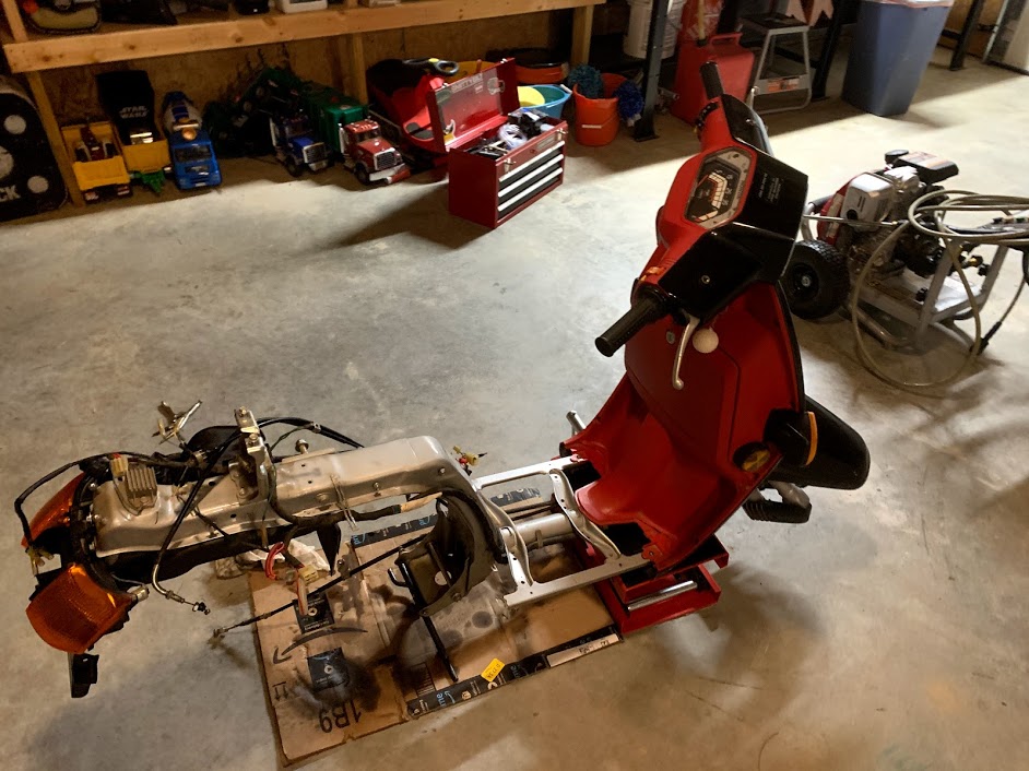

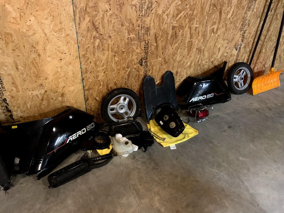

With the Aero 50 back to running, I thought it was time to get it to the point that I felt safe for my pre-teen daughter to ride around the subdivision on. Using much reading on this list, along with a lot of inspiration from members who have brought their scooters back to life, I created my punch list:
  • Pull wheels, inspect, replace tires/tubes
  • Pull muffler. Clean and paint it
  • Drain fuel and oil.
  • Clean engine and frame thoroughly
  • Drain gear oil and refill
  • Polish body panels
  • Install new fuel and oil lines
  • Install new drive belt
  • Install new gasket kit w/ lithium grease
  • Install new air filter
  • Install new battery
  • Put it all back together
  • Fill oil and fuel and ride
Step 1, take it apart:
