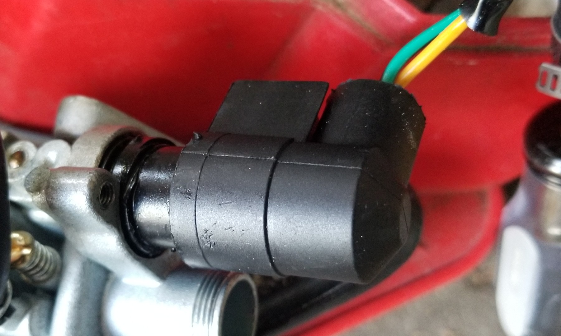

This is what I'm stuck on.

The bystarter, I read on here someone else accidentally ripped there's off trying to take it apart and I'm trying to be more careful than that

The bystarter is held into the carb by a metal “C” shaped tab that is fastened by two phillips screws. Remove the tab then just twist and pull up. The wire connector on the other end has a plastic tab you need to pry up while pulling the plug apart. Its so simple a chimpanzee could do it. If either of these are too difficult to figure out...put the tools down, stand up and slowly back away from the scooter before you hurt yourself.

Also, thats not a genuine OEM Keihin carb. Looks like a cheap $10 ebay special. Good luck getting that to ever run right.

Meatball wrote: Sat May 22, 2021 5:50 pm The bystarter is held into the carb by a metal “C” shaped tab that is fastened by two phillips screws. Remove the tab then just twist and pull up. The wire connector on the other end has a plastic tab you need to pry up while pulling the plug apart. Its so simple a chimpanzee could do it. If either of these are too difficult to figure out...put the tools down, stand up and slowly back away from the scooter before you hurt yourself.
Yeah I got it off the c thing was already off it when I asked, if you're not going to be nice could you not comment pls

With the hold down clamp removed (as you have already done), the bystarter is only held by friction of the o-ring seal. Just gently pull the bystarter.
If it moves a bit and then feels hung up - then there may be an obstruction holding back the brass collar (air control valve slide) or needle of the bystarter. When that occurs further pulling can break the bystarter.
What breaks in the bystarter is the plastic fingers which retain the needle and brass collar (air valve):
