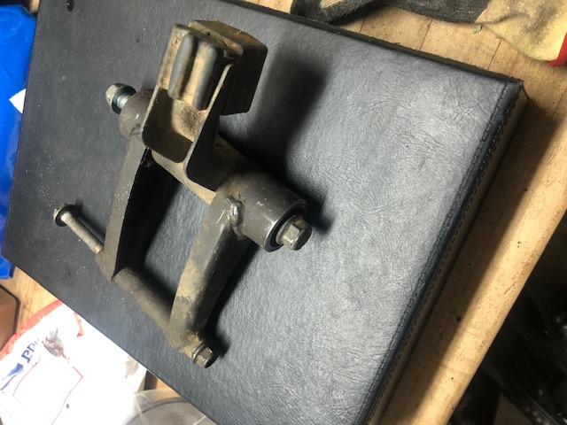

Here’s what my se50 mount looks like. And I went with the SSS weld on upper shock mount also.
Previously kevinstonge 8)
