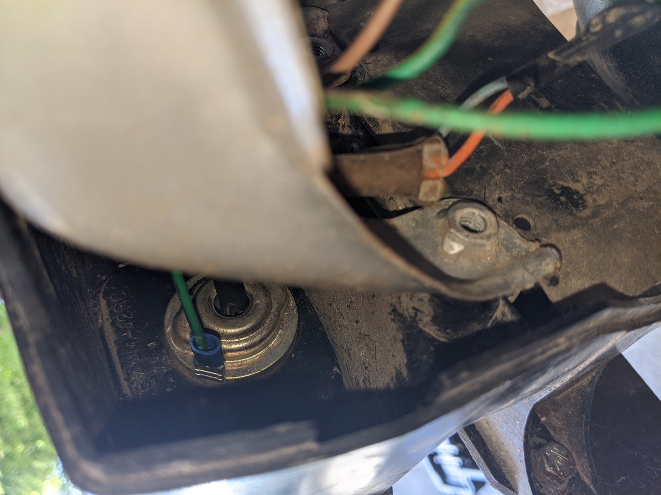

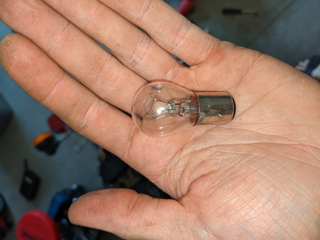

Well, the bulb looks good. Both filaments are in tact within the bulb, no blackening from carbon. No noise of loose filament when shaking.

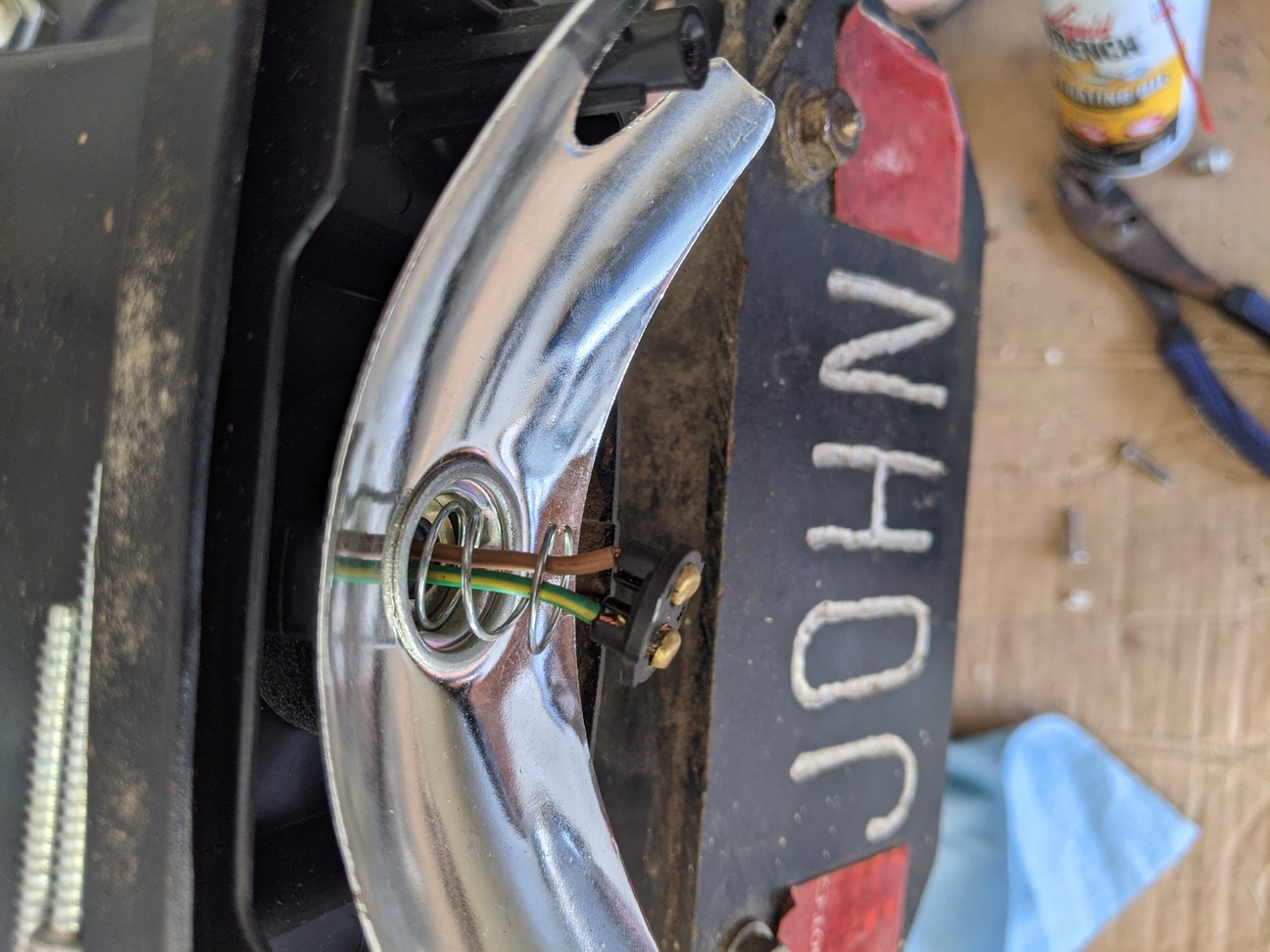

I did notice one of the wires was pretty frayed on the back of the taillight. So I took it apart, trimmed the wires and re-crimped the wires to the little copper contacts where the bulb connects. I also trimmed the third wire for the taillight and put on a new disconnect.
Hooked the battery back up and touched the bulb to the contacts and still no power.
Once I took the taillight apart, it became apparent that you can do a bulb replacement or replace the full assembly, not really splice wires. I feel like the wires are crimped to the copper tight and the bullet connectors are all hooked to the right colors.
Unless you guys have any ideas. I'll just sit on it and wait for an idea or at some point but a new assembly.

Update: I changed the tail light bulb and still no power.
